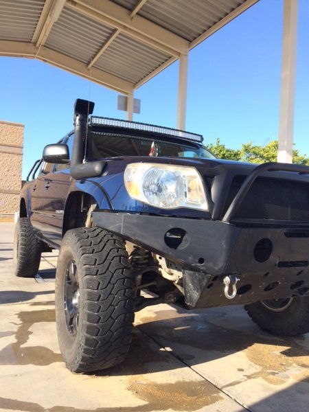

    Hello Tacomaworld, So I have been having a little issue with water getting into my truck. I've researched on the site for awhile with members posting similar problems but I could not find any helpful solutions.
    What happens is whenever I drive in heavy rain/puddles or go wheeling through water I start to develop pools of water on both front floor boards, more so on the passenger side first. When I wash the truck however there is no water to be found, spraying the wheel wells and letting water run down the truck from the roof. I have no fender liners and my fenders are cut 3 inches and the pinch weld is hammered down, I also have the CMC done. My truck is an 05 DCSB. I've posted a pic for a small reference, Ill take more of the wheel wells when I get a chance.
