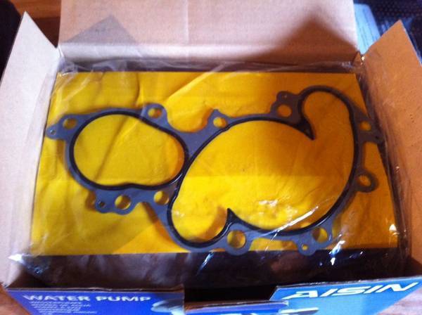

    Changing my timing belt tomorrow and doing the water pump (and everything else in there) at the same time. The water pump came with a gasket (see below). All the directions I'm reading up on say to use RTV. Sounds like Toyota switched to a gasket towards the end of the 1st gens lifetime :confused:
    Seems like the gasket would be a hell of a lot easier (I know I would get RTV all over the place). Anyone have opinions?

    I agree. If you have a gasket then I don't know why you'd bother with RTV.

    you can put a little RTV on the gasket to hold it in place while you install the water pump

    rub a super light coat of gray rtv on the block and water pump super light and use the gasket

    Thanks for the tips guys. When I pulled it all apart I found my truck had the same metal/rubber gasket as the one I got with the replacement in the pic above. There wasn't any RTV on in there so I decided to just put it back the way it was without any RTV. I held a couple of bolts through the water pump as I put it on to hold the gasket in place.

    Yeah my 2001 had no gasket, just RTV. I like the gasket better.

    That gasket has it's own rubber seal on the paper gasket. No RTV is required or needed. A good rule, like you already found, is to put on what was taken off; that only applies to known factory parts.
