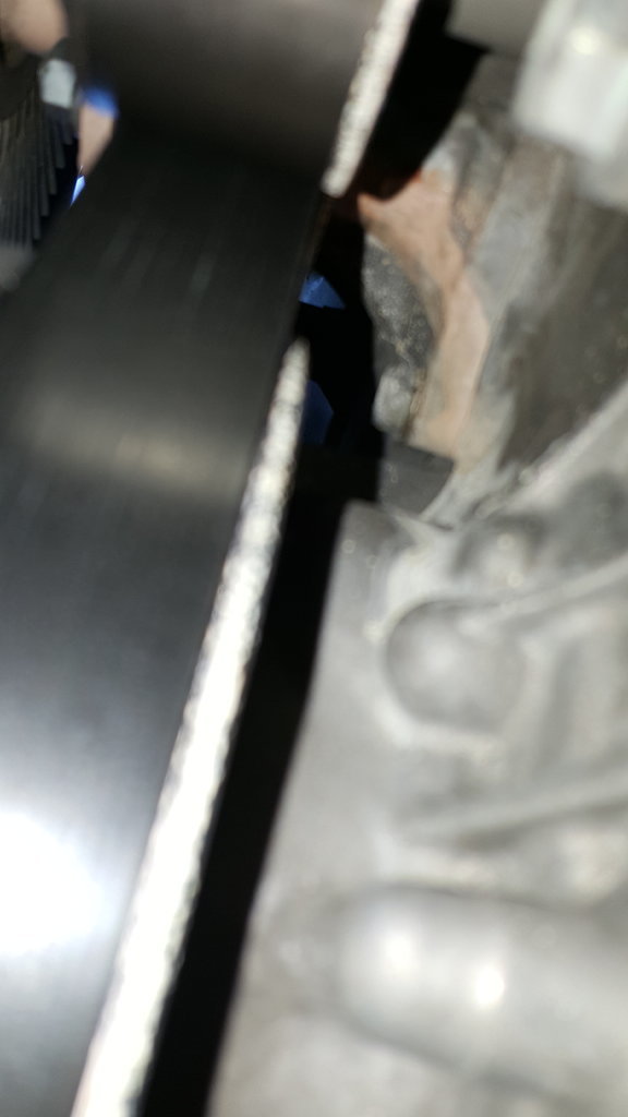

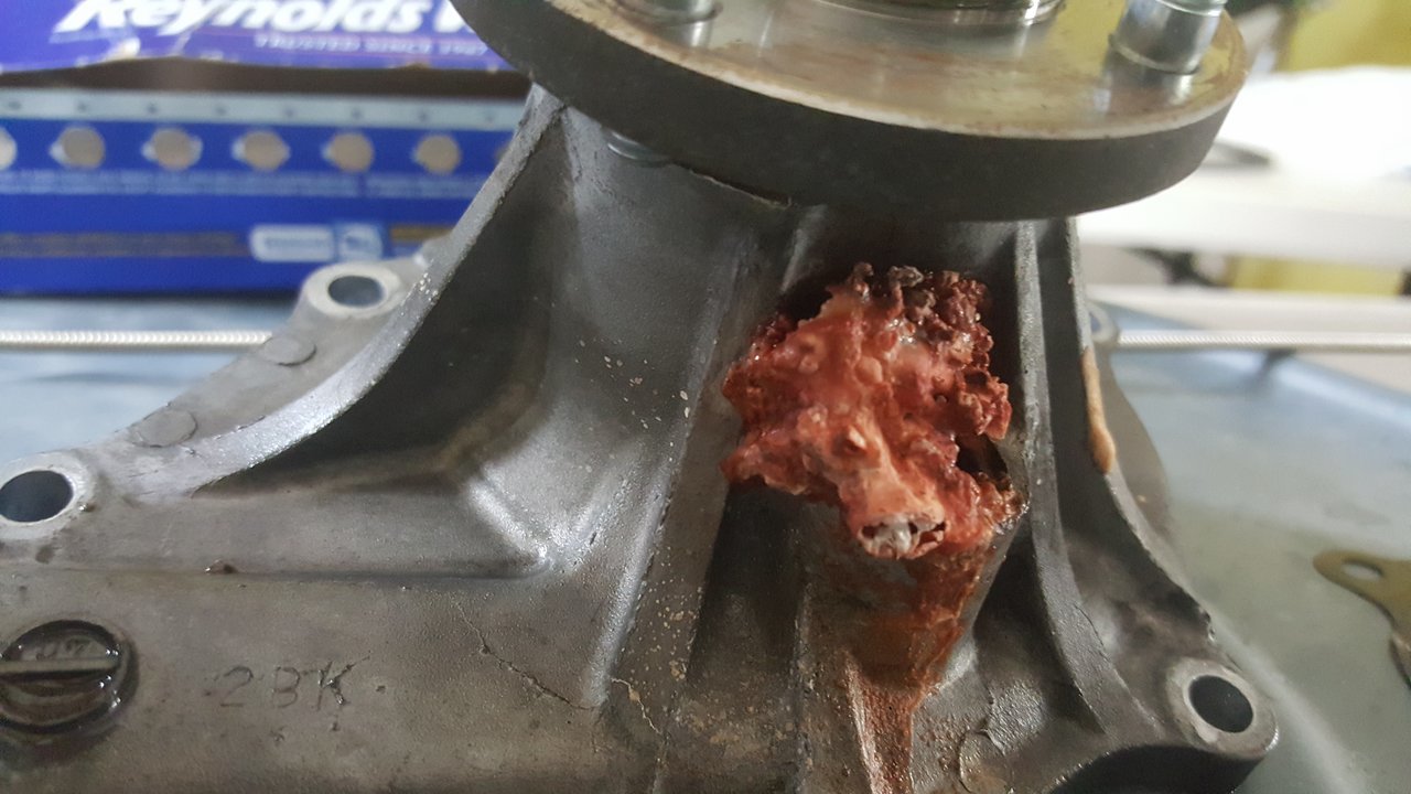

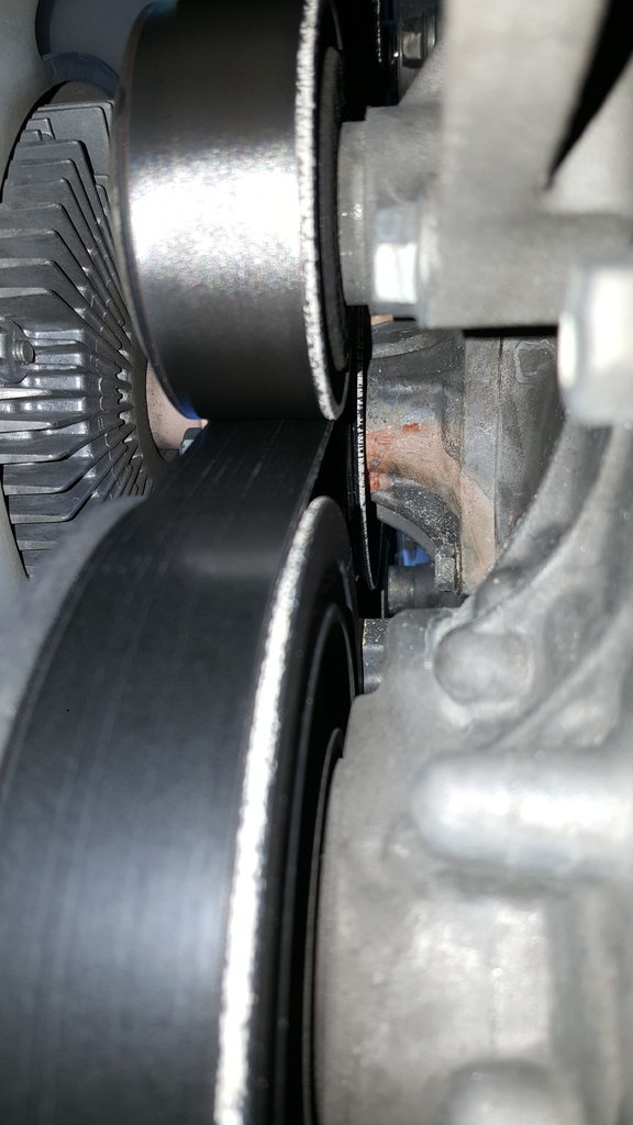

    Hey guys, looks like my water pump is leaking a little. I don't know how long since I've never see any puddles under the tuck but living in an apartment complex theres always oil and puddles of stuff in all the parking spots. I found this during an oil change yesterday. The truck has 118575 miles on it with no major repairs, just regular maintenance.
    My question is, does anyone know of a good place online to get real OEM Toyota parts at a decent price? The dealer quoted $184 for the water pump, $190 for labor, $90 for the belt, and like $96 for coolant (3 gallons).
    I'm going to labor myself with my buddy's help, bought a Gates belt for $40, looking for a water pump now and I can get Toyota red coolant at Carquest for $27 a gallon which saves like $16. Any help in the hunt for a better priced water pump is appreciated.

    Just an update guys, got the old water pump off and new one installed. Thank you so much @EatSleepTacos and @gunny1005
