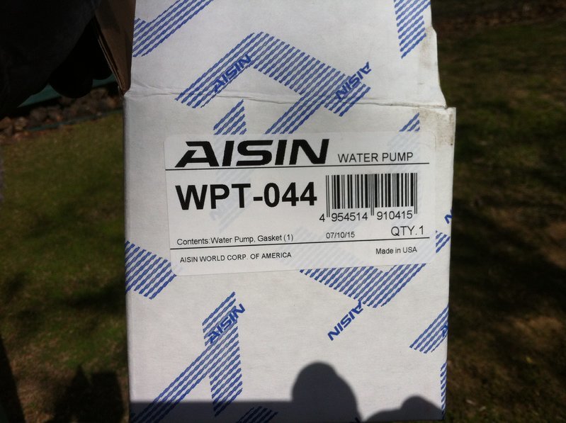

    image.jpg Noticed that my truck was low on water/antifreeze....and found that the water pump was the location of the leak ... Replaced at 150000...!

    Looked at Napa and other local auto parts stores....decided to order an Aisin water pump off of Amazon with a great $$ (Prime). Followed steps in my Haynes repair manual.....1 hour and saved $$$$...!
