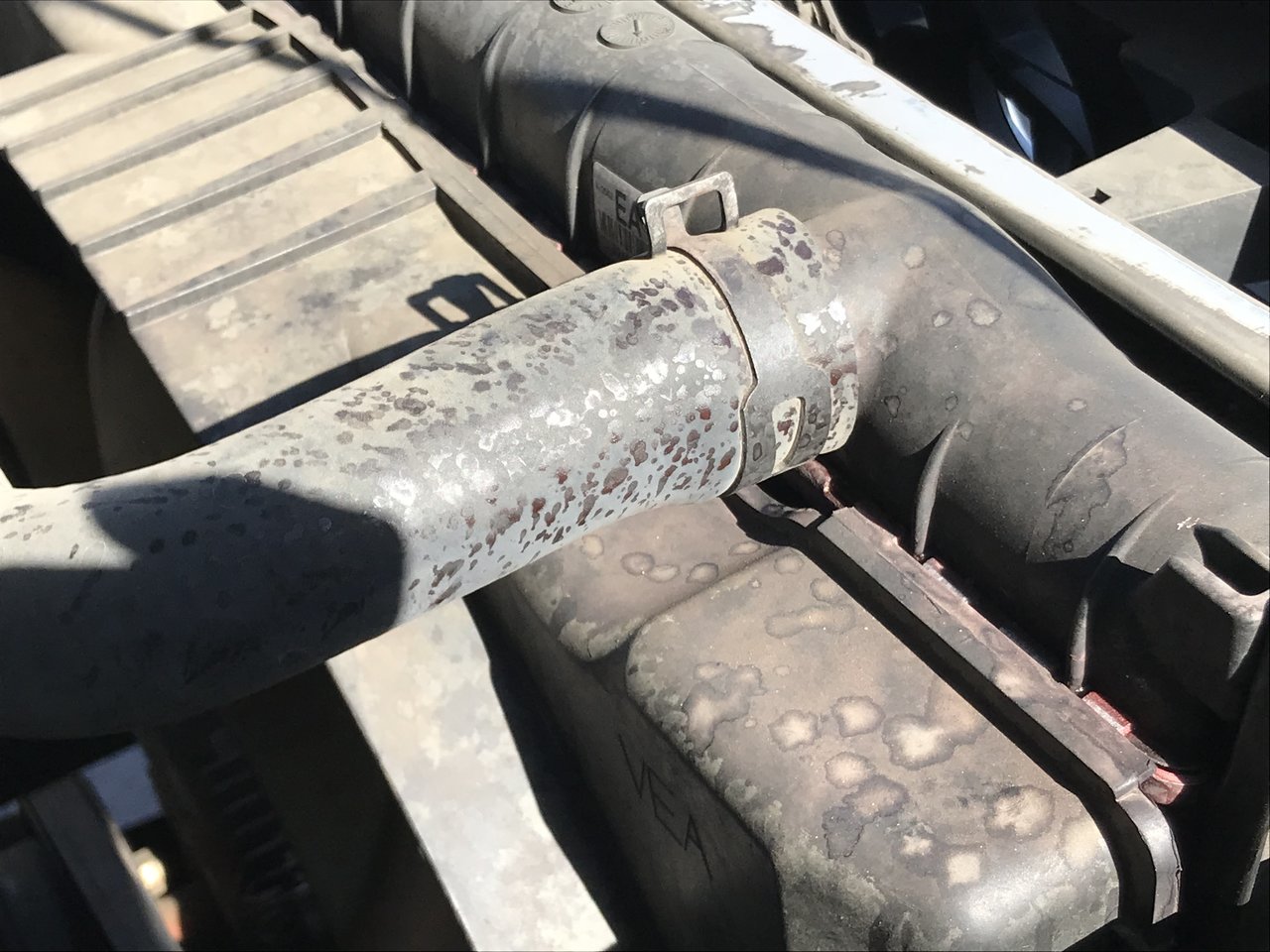

    Hi everyone. I'm new to the forum and looking for some help. If I park my truck for a couple days, I hear a water sound behind the dash sloshing around when I take off. It goes away as if the water spilled somewhere. I do not have a wet floorboard on either driver or passenger side. I popped the hood and notice some red coolant spayed out a little over the radiator hose and it seems to be leaking out or had sprayed out across the top of the radiator. It also looks like I'm low on coolant.
    Can you tell me which coolant to get so I can put some in for the meantime. I plan to pop the hood again later and I can take some pictures. I'd like to avoid going to a mechanic if possible.

    With the vehicle not completely up to temperature can you remove the radiator cap and rev the engine. The goal is to see if there are any bubbles being released into the coolant from an engine leak.
    Sounds to me like pressure build up in the cooling system is causing you to run low on coolant, thus the sloshing. Check out Step 3:

    Done. Looks low on coolant. Shouldn’t it it full of coolant under the cap? No bubbles. FAF49D41-0413-4343-95BB-35B7B16373DB.jpg7BC4906A-B88D-49C6-A8E7-FDD01A5A554E.jpg

    Fill it up to the top and with the cap off start the engine and make sure it doesn't spray out//start overflowing from pressure inside the system. You won't see anything until the fluid is above the fins.
    probably have a cracked radiator right here https://imgur.com/a/H9Gyy

    burp your cooling system w/ cap off till it gets to operating temp and make sure your heater is on so that coolant is flowing through the heater core. could just be a little bit of air.

    Hello Chris, I had a sloshing sound years ago on a 1991 toyota pickup. Turned out to be a bad head gasket. Pretty common on the 3.0 V6 engines back then. Check your oil and make sure it looks normal. Are you getting a lot of smoke out the tail pipe after truck is at normal operating temp? Just throwing that out there. Clearly looks like you have some form of leak going on there at the top of the radiator. I say if you replace the radiator and your still getting a sloshing sound and your antifreeze is still going down... more then likely a bad head gasket. Good Luck!

    I imagine the radiator is cracked as that is the most common issues ive had when I'm losing coolant.
