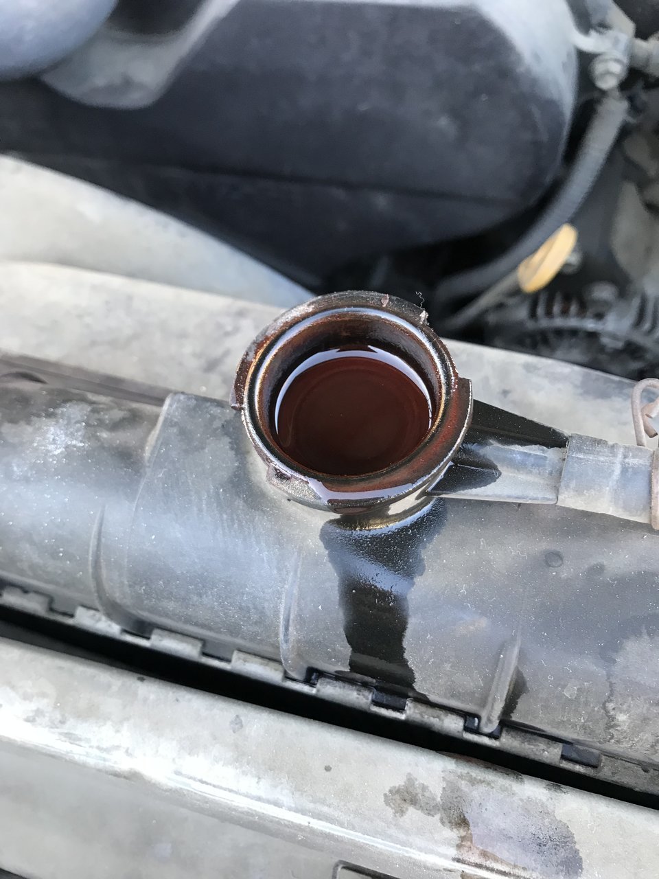

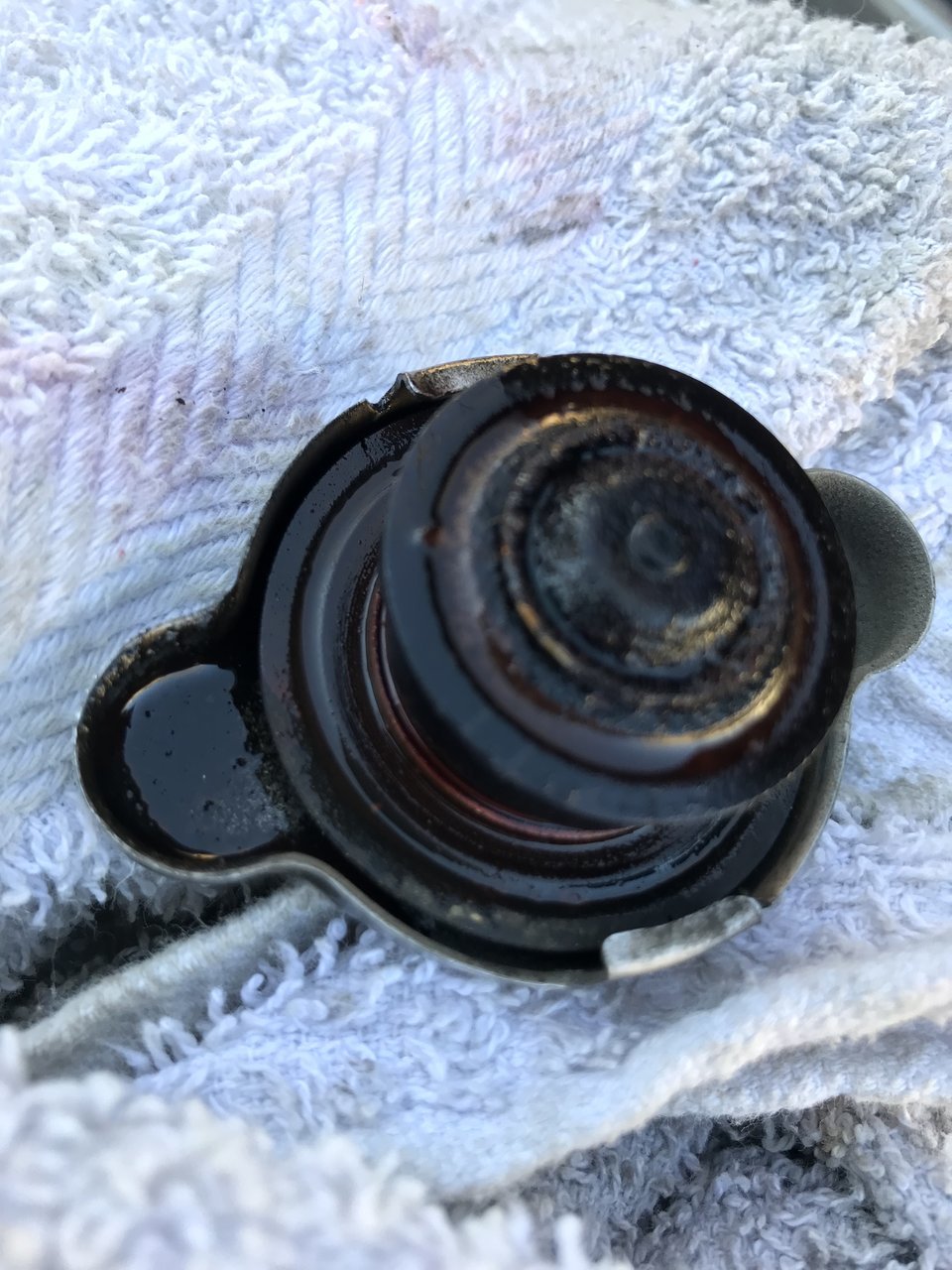

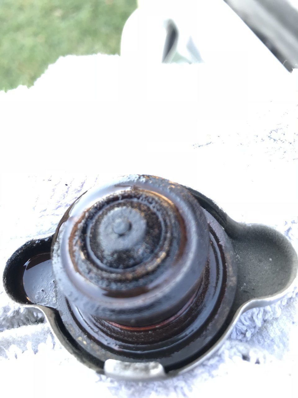

    So I waited for it cool down a bit. It’s still warm but I was anxious to take a look. I popped the radiator cap and it looks bad. You tell me. See pics. There’s a lot of coolant on the asphalt under the truck from the overflow. But the reservoir is now back to full level.

    OK Now I'm starting to think you have a head gasket issue. When you start having coolant pumping out of your overflow there is something wrong. If you are losing coolant and then over heating I would /think/ your overflow would be bone dry as the system sucks it back up when/if needed.
    What I want you to do on your next cold start take the radiator cap off and make sure the system is completely full. Leave the radiator cap off and start the truck. Make sure coolant doesn't geyser out of there. If it shoots up out of the radiator that is a FOR SURE sign that the head gasket is toast.
    edit: Just saw pics from post above - is your radiator full of fluid here or did you top it off? If you lost a bunch of fluid and the radiator is full maybe you just put too much in the overflow :eek:

    Thank you so much for the replies. While you guys were replying, I made a trip to the parts store and figured I'd start with a radiator cap. While I was making the purchase, I decided to rent a radiator pressure tool. I couldn't believe they are free to rent. I hooked the tool up to the radiator and once I got to about 15 lbs, the coolant began spraying out from the radiator. I then could see the 3" crack in the top of the radiator. While I was initially renting the tool, there was a customer next to me who was also a mechanic. He came out and started looking at everything and told me my radiator is done and I should change the thermostat while I'm at it. He has a shop down the street from my house and he said just buy the parts and he'll swap it all out for me for $100. Sounds a little too cheap but I'm a little broke from Christmas and he truly does sound legit. I have a knack for filling people out and not being ripped off by people who don't know what they are doing. Ask me how I found that out.
    Also, I think I did put too much coolant in the overflow, which caused what you saw; too much coolant in the radiator. I'm trying!

    The crack is behind and below the radiator cap. So, if you stick your head over the radiator cap, you can see it just below the cap and to the left. The coolant sprayed out all over the "CAM 24" text. Weird thing is, my original photos have coolant on the left side of the radiator hose which doesn't make sense as to where the crack is. Maybe there's multiple cracks.
