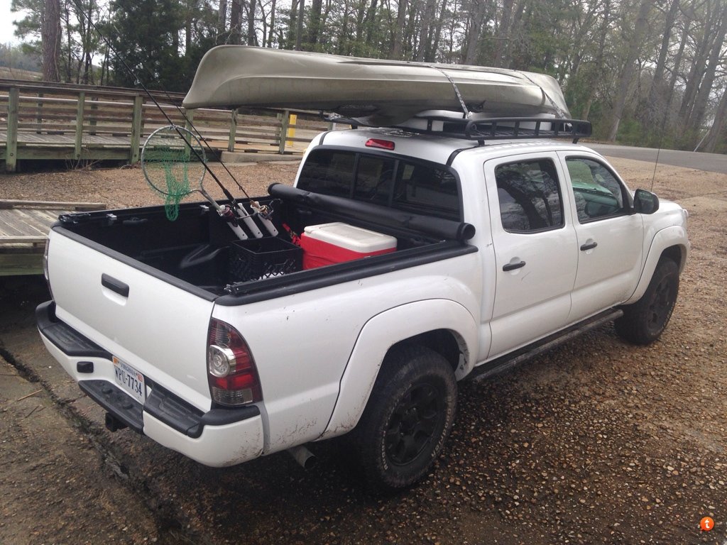

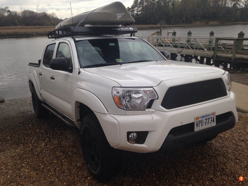

    Baja Rack from bajarack.com. Bolts in under the weather stripping and holds more than double the weight that the OEM does. Easy install. I am more than satisfied. I just ratchet strap it down. That's a 12ft kayak on there btw. yvatytam_f01dae9fbb34aefa5ebcf6f649a614e6c72967cb.jpgu2a6ynat_38819dc105f1b942e7f37c5ecabd1c600615b9c9.jpg

    Cool thanks for the tips and options guys, much appreciated. That baja rack looks great too, super versatile. Seems like the common theme here is the Xsporter so I'm going to look into them. Thanks for the link Chris, seems like it's exclusive to the US though

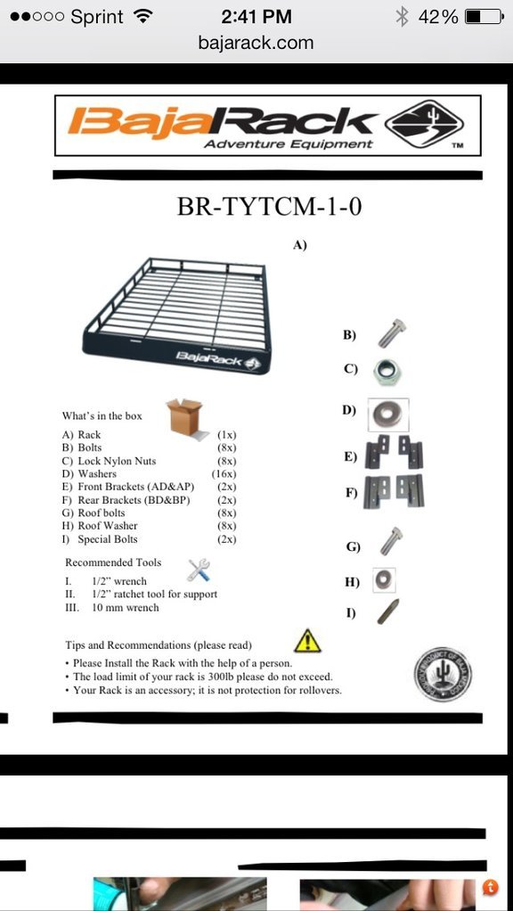

    by6y3ame_07194ac3e72444a314cc47ef2346082d8f34ece9.jpg7u8ebeny_b9f861ab574c9871c19cb94c94fdc500413451ec.jpg
    http://www.bajarack.com/toyota-tacoma. 610 is the price now. I installed it by myself in like 30 minutes. With a wrench, ratchet, drill, Dremel, and waterproof silicone rtv. You can download installation manual from the site.

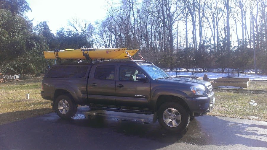

    I bought a different product from BajaRack, it's the flat rack. I bought some custom pads from my board bag maker so I can transport it uncovered.

    You can tell it's there. I don't mind. I plan on getting some off road tires when these wear out, so I'm sure everything will even out.
    I came from a full sized truck and I couldn't get used to the short, narrow bed. I wish I had photos of everything I've put up there. SUPER solid at highway speeds. This is a set for the local little theatre.
