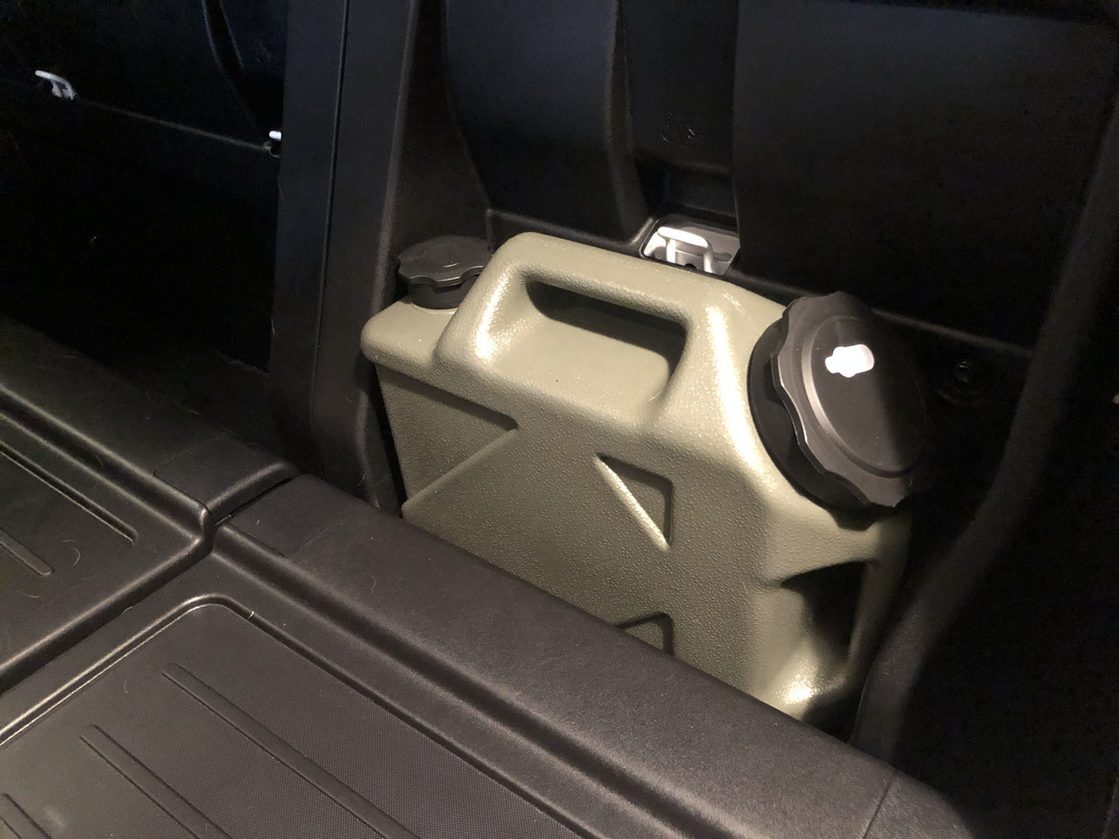

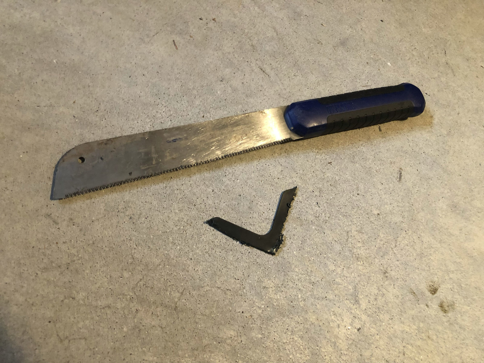

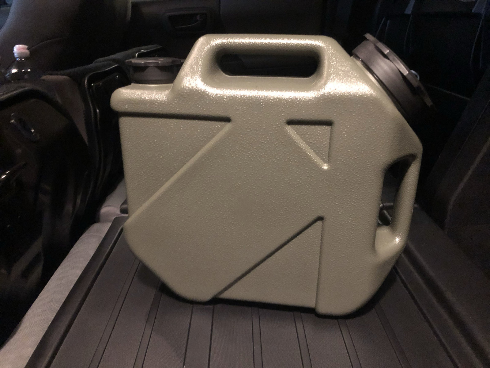

    Had to share this find. It's almost like these containers were designed for the storage space behind the rear seats in double cabs. On the driver side, I cut out the little lip in the bottom of the storage area (took 1 minute with a little flexible flush cut saw). After that, it fits like a glove. I do need to push the seat backrest just a bit more firmly to latch it in place, but I like that - the plastic flexes just a tiny bit and keeps the can from rattling. On the passenger side it fits with no modification and no flexing of plastic. The one I got is made by Digury, but there are several manufacturers selling what looks like the exact same thing under different names on Amazon in OD green, tan or black - all in the $25-$30 range. Search for "2.6 gallon water container", but be careful - there's a 3.2 gallon version that looks almost identical but will not fit. I'm ordering a second one now... 20 liters/5 gallons of water behind the seats with room to spare is nothing to sneeze at.
