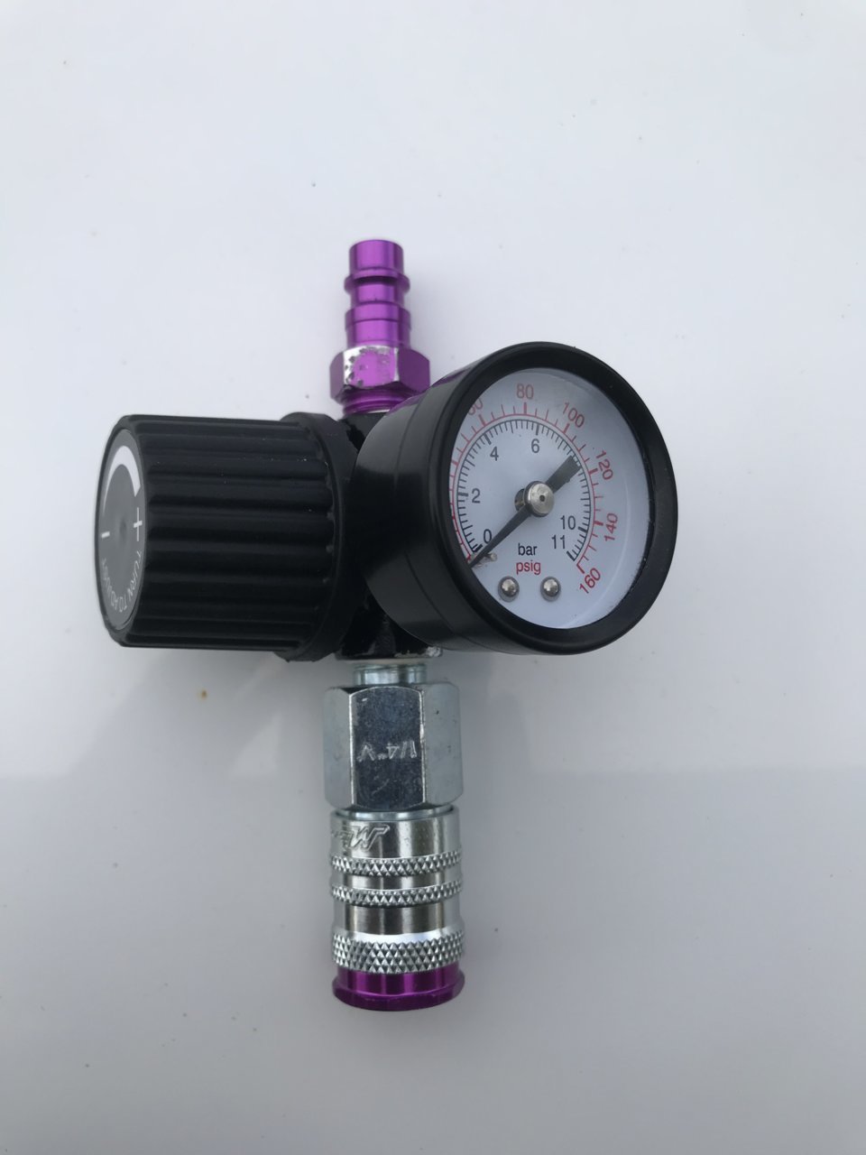

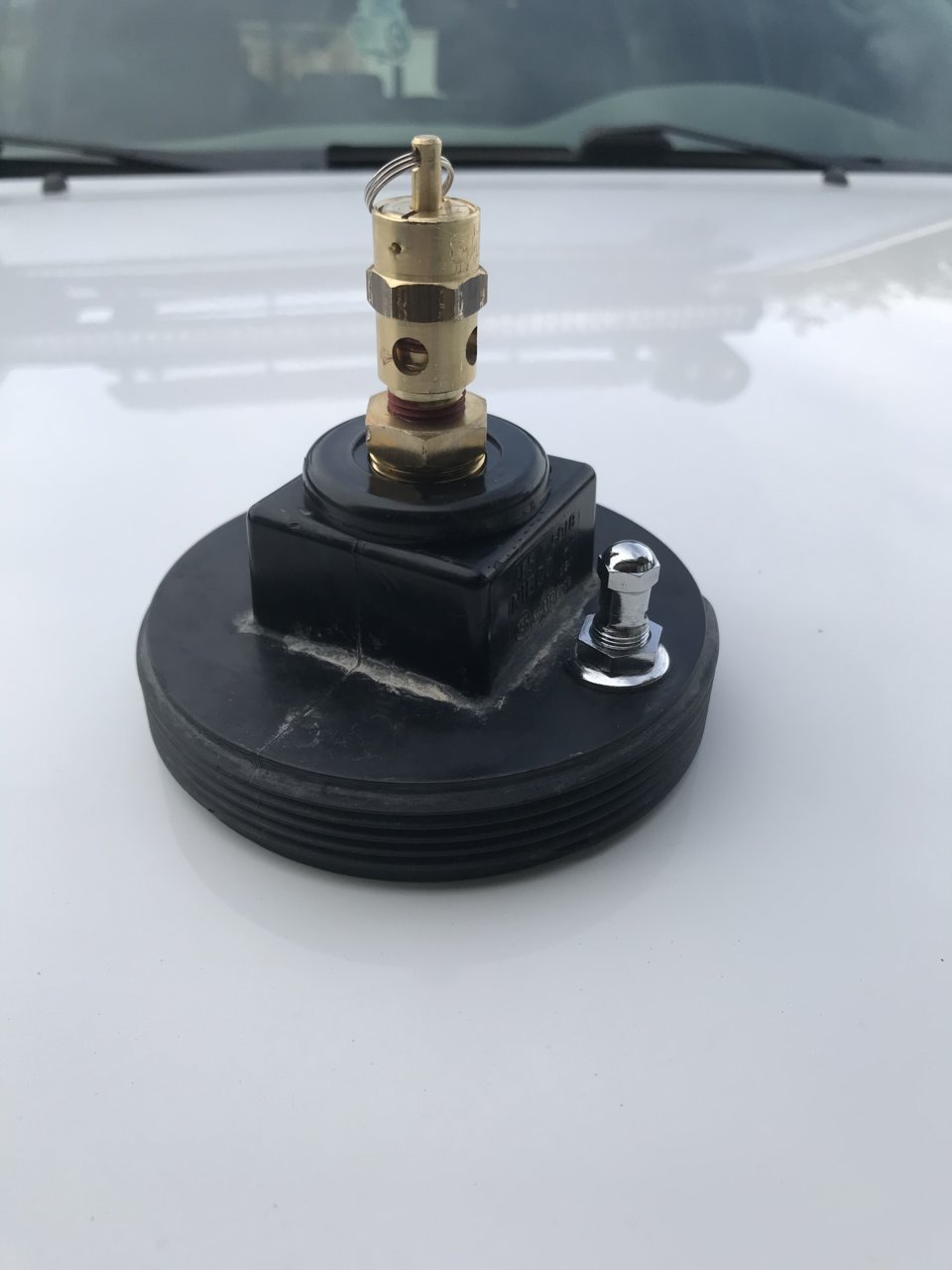

    #40
    Hennebury
    Hennebury [OP] Active Member
    Sep 18, 2018
    #266647
    27
    Nick
    2012 Tacoma TRD Overlander
    Too Much
    Here’s my regulator and the cap I made I have a cap with no fitting added to it from when I’m traveling or wheelin I switch it out when I wanna use the shower or water tank..... i have a arb twin Compressor with no tank but it’s 100% duty cycle and I only run the reg at 10psi the arb cuts in on 100 and off at 150...... I’ll take pics of the shower head when the rest of the parts show up and post that then
