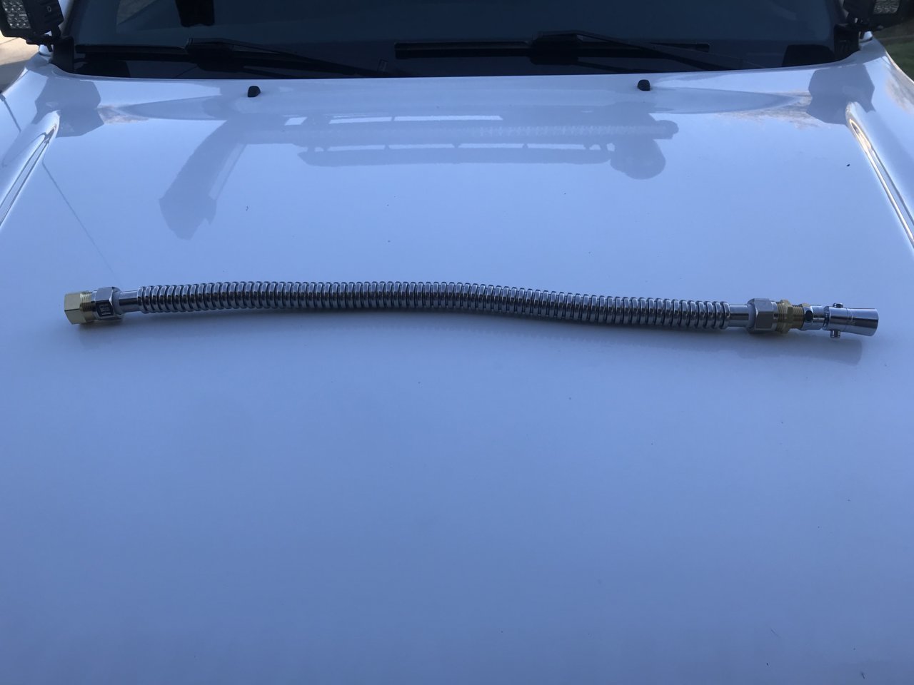

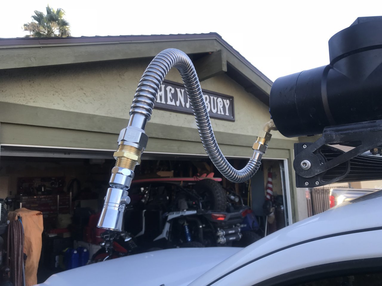

    Here’s the shower head attachment I made it’s flow rate is 1.6gpm at 80psi.....So not sure how much that will drop at 10psi but I would think my 3.5 gallons of water should give me around a 4-5 min shower ..... also it has a on and off button so you can get wet turn it off soap up and then on and rinse

    Nicely done. A lot nicer than holding the hose/shower head. I need to make a better shower head setup for mine. I just use a hose with a shower head. Even with the travel trailer Im building, I plan to keep my solar heater for when I am out working in the dust.

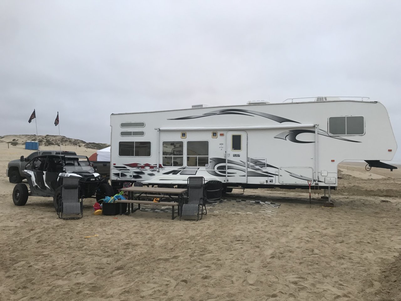

    Here is my water/shower/base camp setup. Just got back from a week in Moab and a 2nd week in CO.

    Little hard for the taco to pull my toyhauler lol.... This is more for quick weekend adventures where this won’t go.... and our last Death Valley loop was around a 200mile trip.... in one way and out another with no backtracking so a base camp wouldn’t help me much on those kinda trips

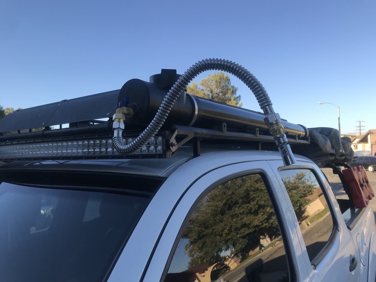

    So I made a heat exchanger on my on board shower, it uses the hot water of the truck to heat the shower water, works great

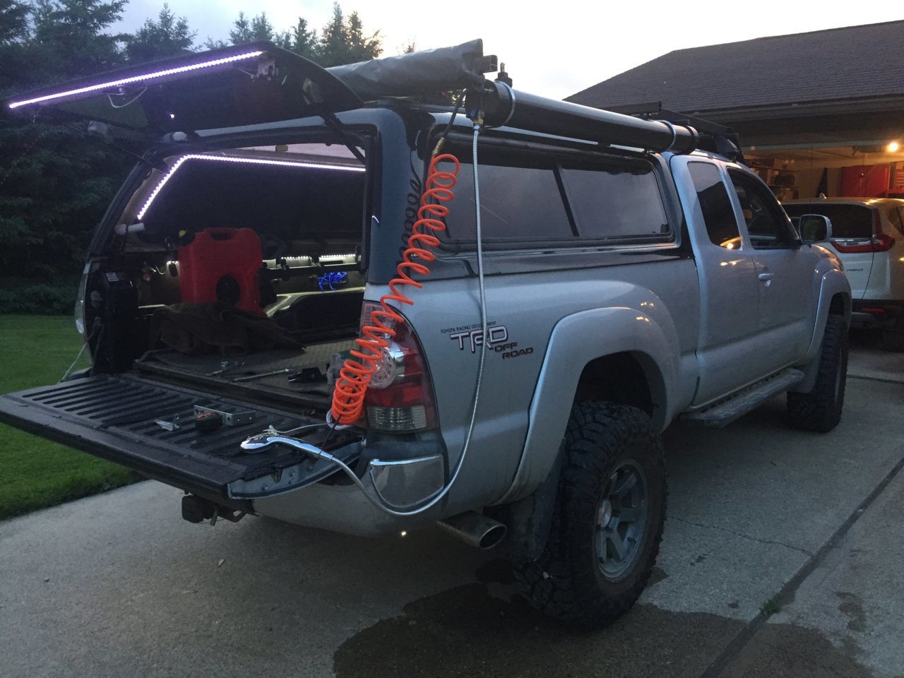

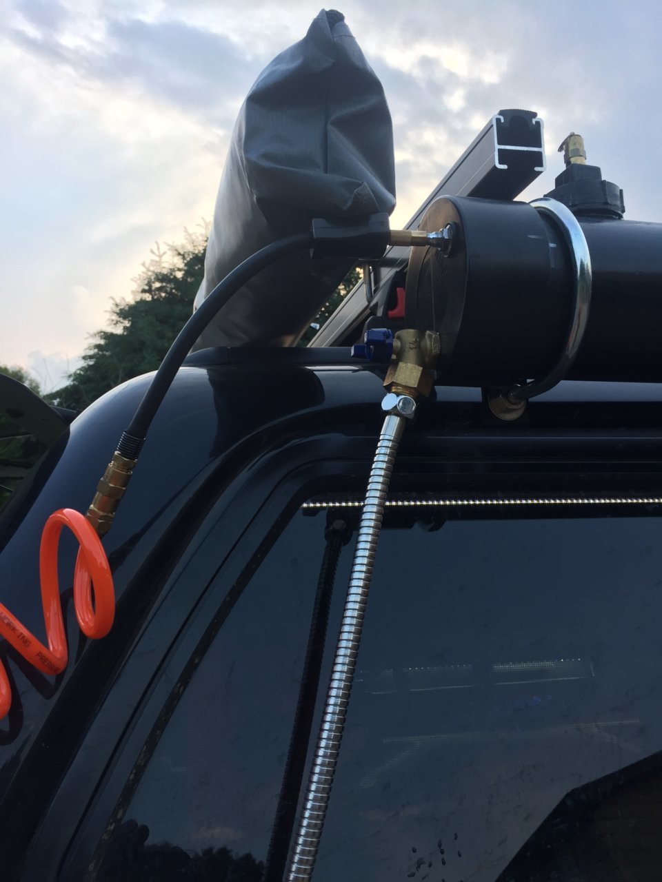

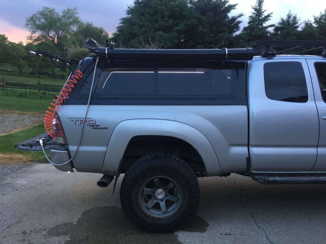

    20190611_204855.jpgjust built one a few days ago. love it. holds pressure for a long time but im still trying to get the screw cap from leaking completely. overall very handy and liking it so far.

    5’ 4” ABS. Boiler drain valve. Bolt on Schrader valve. 30psi pop off valve.
    Wrap Teflon around it. Should seal up enough to keep you happy. Did this with mine and it works great.

    thanks for the tip. i have it wrapped now but am gonna go buy better quality t-tape and see if it holds longer.

    I wrapped a butt ton around my filler cap. Put on what you think is good, then double it.
    I’ve had the cap off and on probably 50 times and it still seals well.

    right on. will do. does yours hold pressure overnight? ill fill it to 30psi and the next morning its down to like 4.
