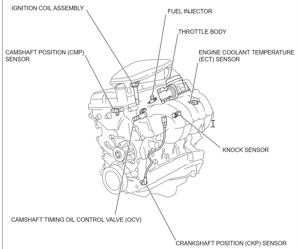

    Thanks for the info. I guess it's acting normal! I would still like to know the locations of the sending units in case I need to get to them!
    Thanks!

    TnShooter
    TnShooter The TacomaWorld Stray
    Sep 2, 2010
    #42625
    21,361
    Deogee
    07' TRD Off-Road, Auto
    STOCK
    Jimmyh likes this.

    Ok, thanks! I assume the sensor is behind the runners. Does it signal the ecu and gauge or is there another for the gauge?

    I believe the PCM reports the temperature to the gauge via the CAN network. If you have the correct scan tool you can "sweep" the gauges to verify their operation.
