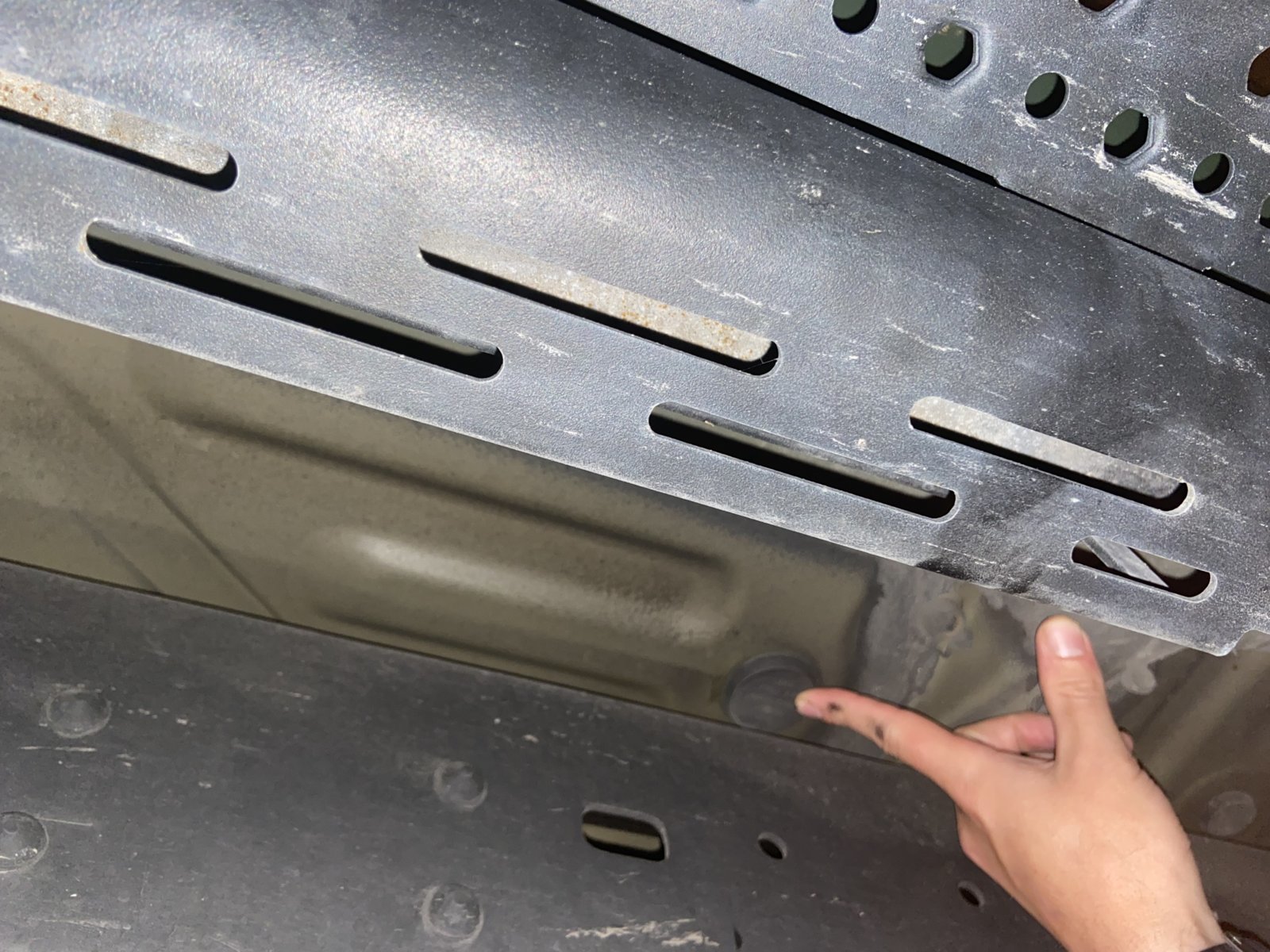

    Pic for reference of where I’m at under the truck.
    There’s a bunch of these rubber plugs under the truck. This one is right under where the feet would be on the rear passenger side. There’s another smaller one further forward possibly under the front passenger seat. I’m not saying these go through to the carpet but if they are missing, I’d check it out.
    roxtaco likes this.
