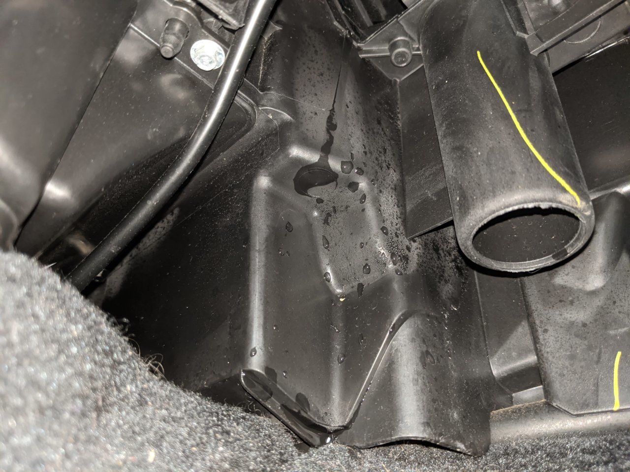

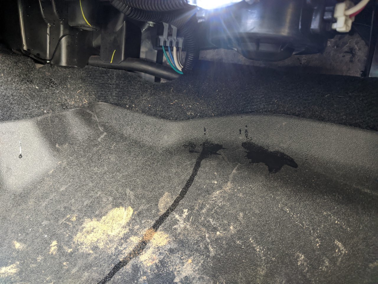

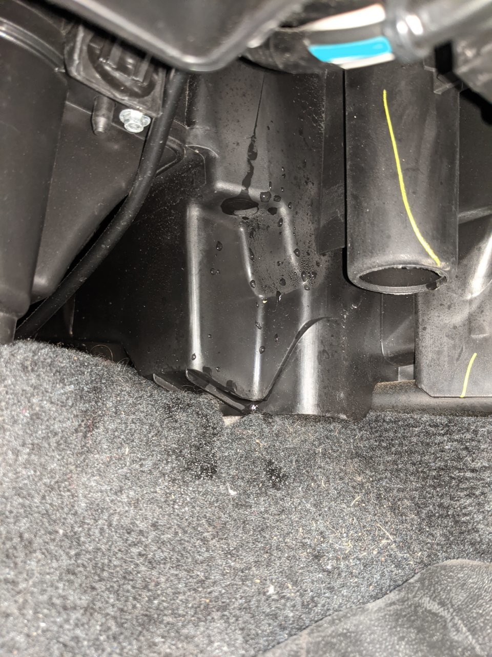

    Good morning. Just got back to the house and wondering why I have water under my dash. 2017 trd sport. Will be contacting dealership as well PXL_20201023_132244030.jpg PXL_20201023_132308133.jpg PXL_20201023_132331659.jpg

    Do you have a roof rack?

    Hopefully that's not from the heater core or the AC condenser.

    Has the windshield ever been replaced?

    Rodent Pee That is what mine was from

    I bet it's the AC condensate hose that is clogged. For some reason it seems to be a common issue with a lot of Toyotas. It's pretty easy to check that, just blow air through it from the inside, blowing the air down through the hose so that it blows out the crud. You can also just take the hose out altogether and clean it outside of the truck and then reinstall it.
