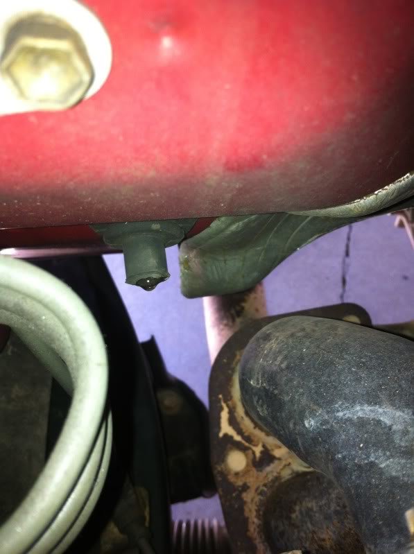

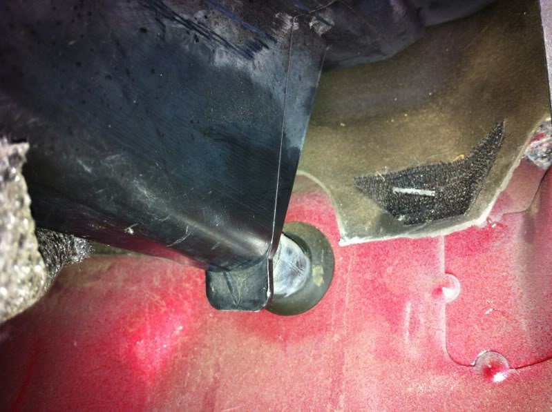

    The simplest diagnostic is to check to see if your evaporator box is filled with water, if it is then your drain plug is clogged. It's located on the firewall in the passenger side footwell. Here's a picture of it (you can see the drain/plug exiting through the firewall). Give it a gentle shake, if you hear sloshing, it has water in it.
    If it's clogged, find the drain plug on the engine side of the firewall where that ^ exits. Picture below:
    Some have 90° aluminum tubing in that rubber nipple, mine did not. I just took a coat hanger and gentle gave it the business. Leaf litter and debris and about 1.5 cups of water came pouring out.
    That solved my issue.

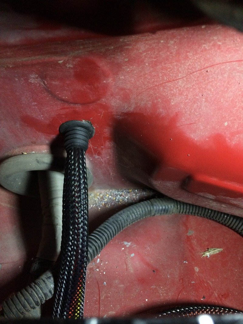

    There are two (that I know of) on the firewall. One on the passenger side, pictured here (it's the large one in the background, not the small one in focus - I made that one):
    There's one on the driver's side as well. Harder to get to/see because of the master cylinder et al. I can't find any pictures of it, probably because I was so defeated after pulling 2 ga power wire through it for my amps.
