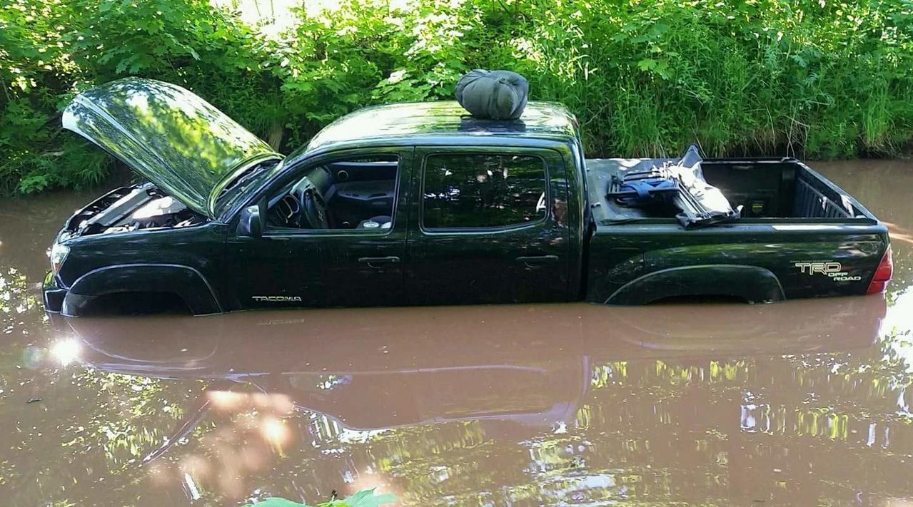

    This truck has been amazing so far but after a weekend on a trail coming back from fishing this water hole prevailed to be deeper than expected.
    How the truck got the problems
    The truck could not get traction on the bottom of the water hole due to me being carelessly in 2wd once we came to a dead stop I kept the truck running and did my best to keep it from hydro locking. After sitting in the water for a few minutes the truck horn started to go off so we shut it off and pulled the cables off the battery while we waited for over 2 hours to get help while the truck filled with water. Upon pulling the Tacoma out of the water it started right up water was high in the truck but the gas and brake pedal were still showing. Once it was out of the water I immediately brought it to my house changed the oil, flushed all the other fluids at a local shop, and sucked up as much water as I could with a steam cleaner.

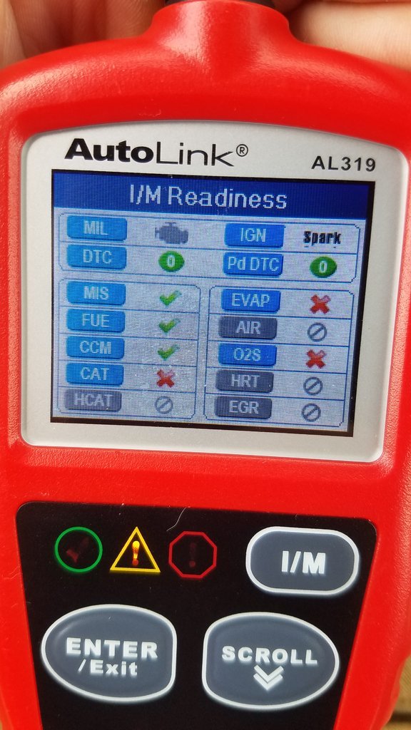

    The mechanic that fixed the starter and wheel bearings advised that when he looked into the codes that it was throwing codes for every single component for the airbag system, the ecu, and many other components. When using my co-workers Autolink AL319 I did not see any but one code for spark plugs.
