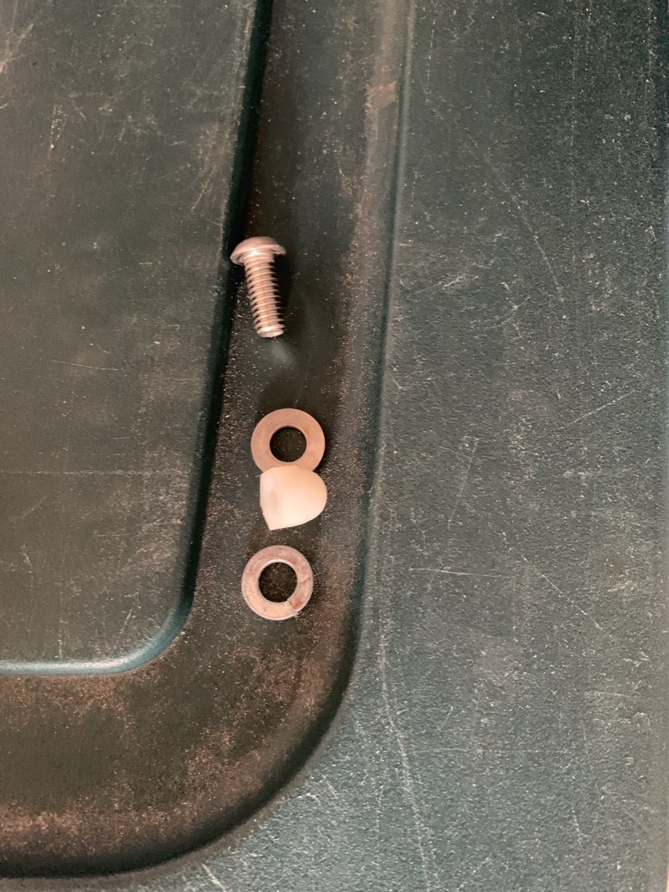

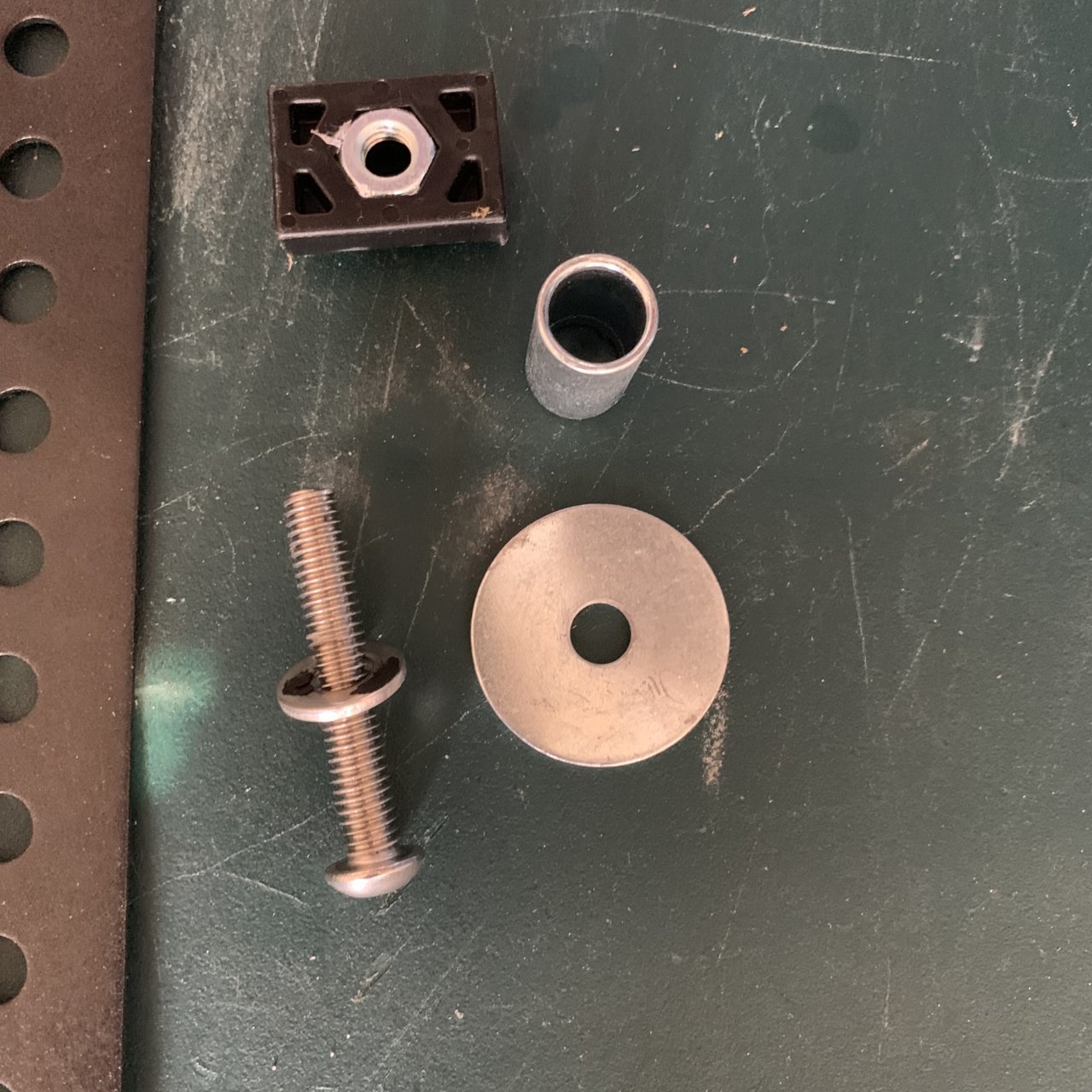

    I just used some metal strapping to drop the water port down to the bed. the photo shows 3 straps, but 2 is all that is needed and what i use now.IMG_0695.jpg

    Part list for what you used???

    metal strapping
    3/4" bolt
    2" bolt
    lock washers
    washers
    plastic nut caps
    T-nuts
    The assembly blocks the cubby when the water port is in place. Currently looking for quick release connectors for the top but this works great.
