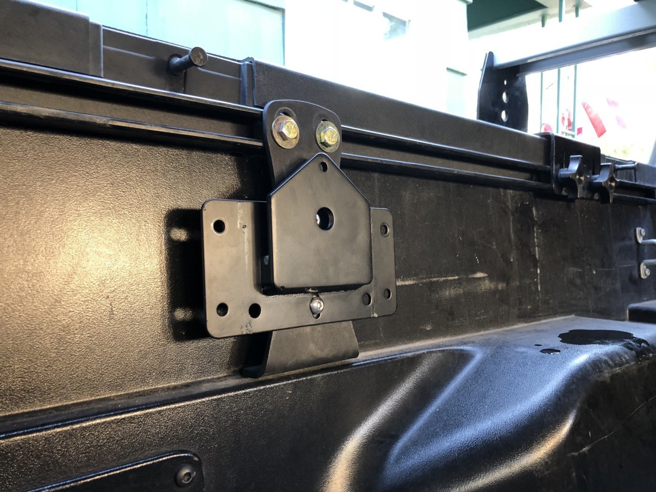

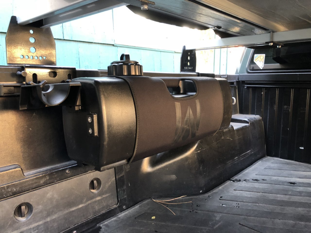

    I used a Relentless Fab quickfist Mount to bolt the Waterport bracket to. It is extremely solid and there is no play. It also drops it down a bit. Bolting the Waterport bracket directly to the rail causes a lot of play and stress on the rail because the bottom of the bracket isn’t supported.
