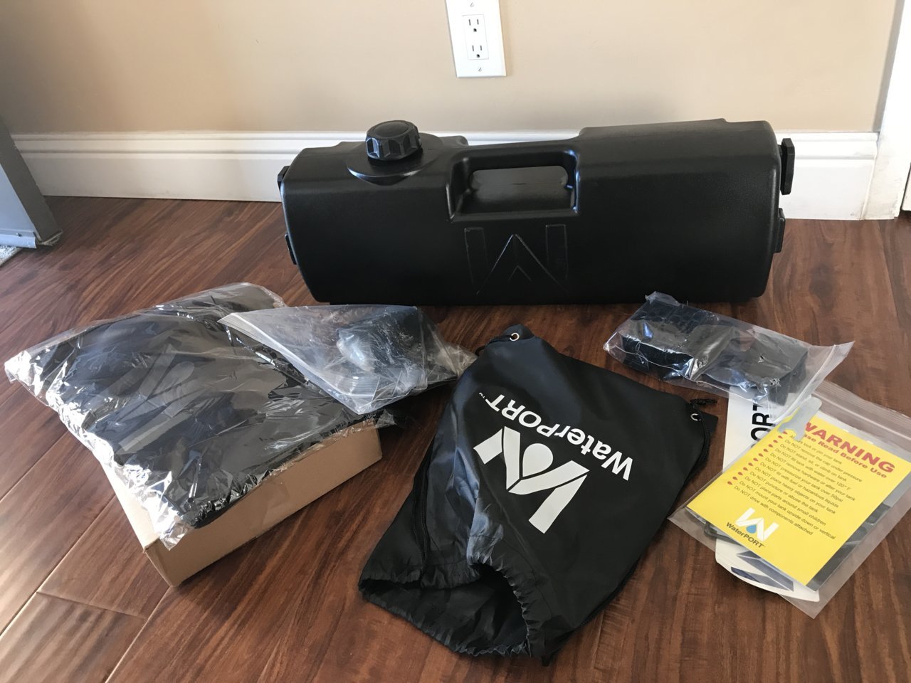

    image.jpg Got it in today, including the sleeve most of you guys have had missing. Now the install

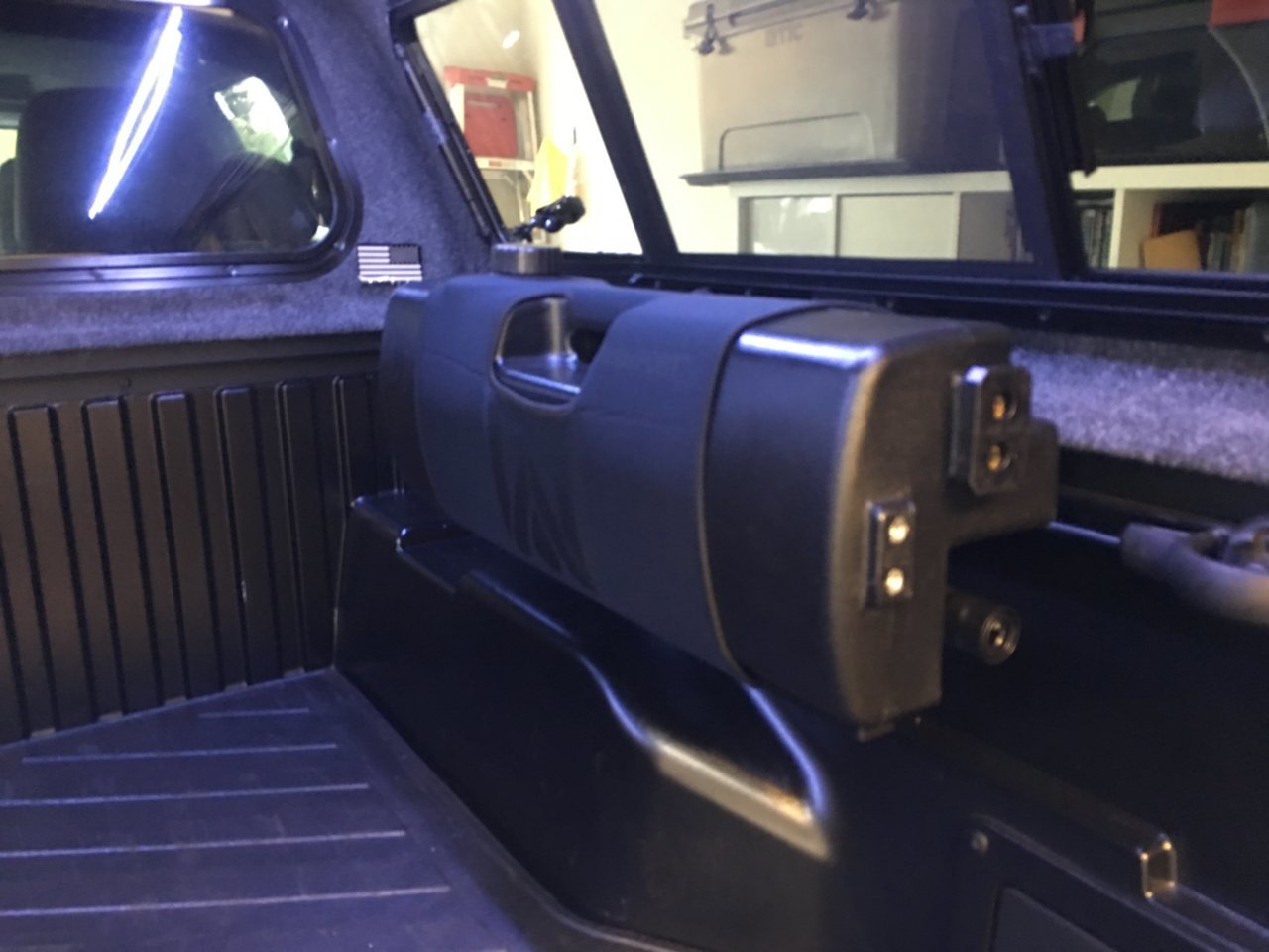

    Received mine today and installed it right the way! Missing bolts from the package but I found the right one from my tool box.

    Damn that sits well in there with a camper. I need one now.
