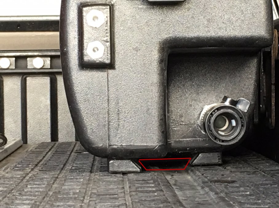

    This is what I'm going to try, a block shaped like this:
