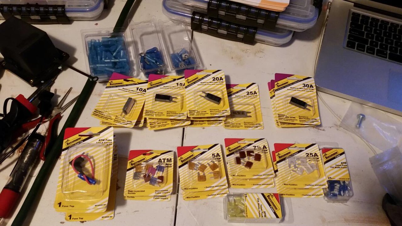

    8,414

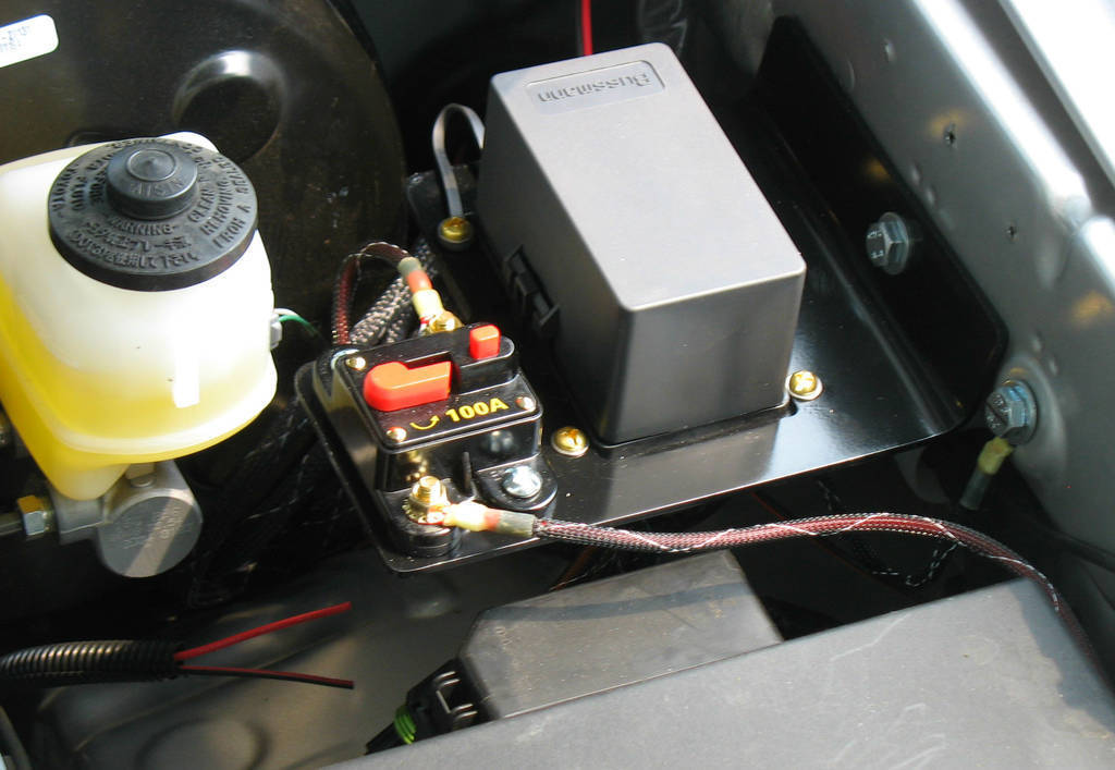

    Pretty easy install. The most work for me was the few minutes it took to fabricate a mounting plate from 1/8 inch aluminum. I don't have a break to bend the aluminum - but do have a large vise that made a pretty clean bend. I kept the mounting plate small (6"x9") as to make the whole assembly as compact as possible.
    There are two places on the fender well that accept a bolt. Skygear includes a bolt in the kit. I only used one bolt to secure the mounting plate because the whole thing doesn't weigh much, and then bought a second bolt to use as a ground point.
    I added an inexpensive 100 amp breaker to serve as a master power shut-off. That away I don't have to unhook anything from the battery when making changes. My circuits don't draw a lot of amperage, so having a functional breaker is really not an issue.
    I'm re-doing my switches and a few other electrical items at the same time - so nothing is really hooked up at this point other than the power lead to the relay box and ground. The actual wiring-up process will happen over the next several weekends.
    This set up is so much better than the mess of full-size breakers I had screwed to the side of the fender-well with funky inline fuse holders.

    Thats a beautiful piece of work there. I think from now on I might just include the 2 bolts instead of just shipping the one.
    If you need additional pins, let me know.

    Thanks, it turned out really compact the way I was hoping.
    2 bolts? I was thrilled that you included one! Sure saved me from trying figure out which metric size bolt to buy from the hardware store.
    If I take my time and drink some coffee before hand, I shouldn't need additional pins - but you never know.

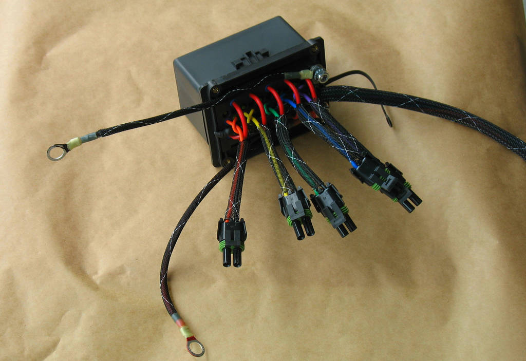

    FYI, I normally use 3/8" for the main harnesses on the RTMR and 3/4" on the RFRM. Individual and 2 wire runs are 1/4". (referring to the braided loom)
    I can do the Kevlar for people to if they want it. Keep in mind, IT IS NOT CHEAP! But if it is what you want and want the ultimate protection for your electrical system. It is what is used in most mission critical applications.

    Top quality, brand name components all by the same manufacturer. Bussmann products from start to finish.
    Just in. Breakers, fuses, connectors and add a fuse fuse tap.
    That's just a taste, the box is huge!

    Those mini circuit breaks look really interesting. Didn't know that they existed until you posted some pictures. Had to look them up to see what they were all about.
    So, if you used these instead of fuses on our trucks - which type would you recommend - the type 3?
    Not sure that I understand the application of each type.
