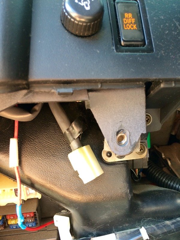

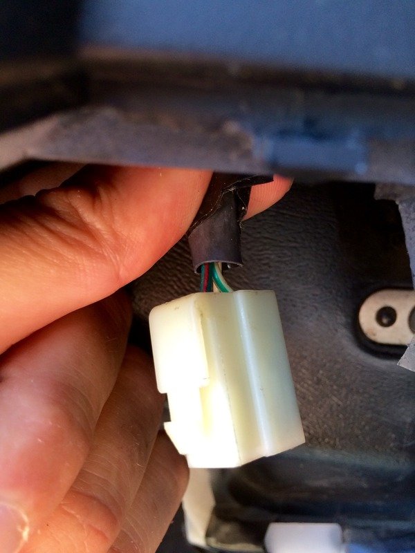

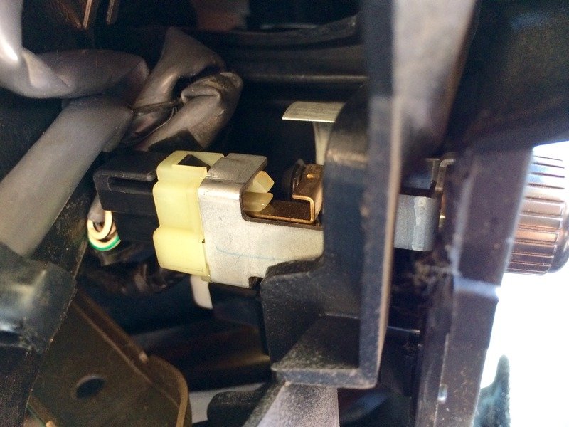

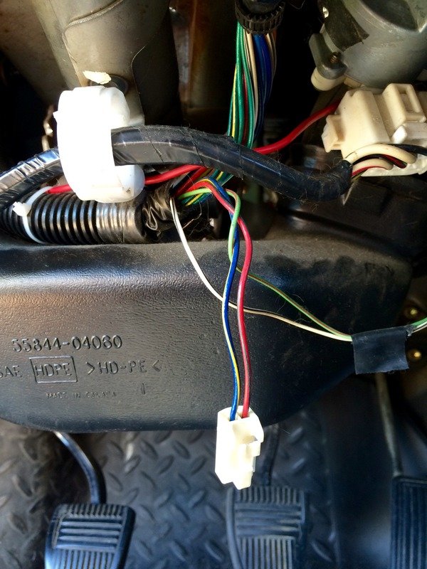

    Okay... here are dimmer wires and unused wires/connectors/harnesses lurking behind my lower dash.
    1998 Tacoma Xtra Cab, 5-speed manual, SR5.
    Need help identifying some wires/harnesses please. I ask because I'm trying to hook up dimmable illumination to my switch backs (built by @skygear) and need to know what to tap into. I do not have a clock or wires that go to it (that I know of) and I do not have an ashtray light bulb or wires that go to it.
    Here are things that I've found under my lower dash.
    #1. This is located just under the steering column (you can see it in the background). This wire harness has two wires going into it. Blue with yellow stripe and red with black stripe. 3+ years ago two people told me two different things, with no confirmation: Could be the wiring for the clock, could be the wiring for the factory alarm system. Two things that are not equipped in my truck.
    #2. This is located behind/below the dimmer knob/clutch cancel/rear locker switch area. This wire harness is literally just hanging there. It has three wires connected to it. Yellow with green stripe, green with red stripe and yellow with black stripe.
    #3. These are the wires that are leading to the back of the dimmer switch. At least as far as I can tell. There are a couple of other plastic housing between the back of the knob and these wires. As far as I can tell the wires are yellow with green stripe, yellow with black stripe, and possible two more that I can't really see.
    I attached the wiring diagram (46 pages) for my truck. I honestly don't even know where to begin to decipher this thing.
