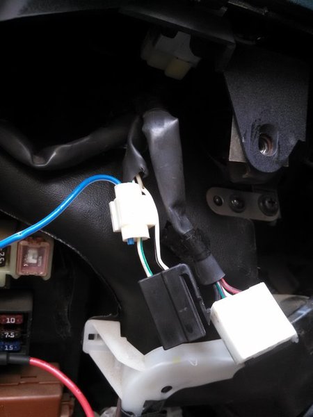

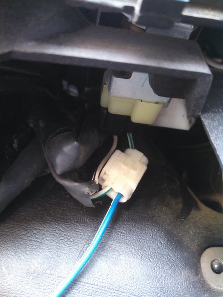

    Here1438382471218-192726308.jpg is my dimmer wires
    The blue wire us my illumination wire.

    @bry838 When you say you get light when you pierce the W-G wire, Where is the other end of your test light attached?

    It can be anywhere steering column or even the W-B(I pierced it too and stuck a needle through it to clip my light to). All configurations result in backwards dimming, or nothing at all.
    How can there only be two wires and only one of which carrying current? I can't get my test light to light up with the W-B which is obviously a ground and works as such. But seems there needs to be two positives, one in one out....apperantly not though cause I can dim my dash just fine.

    W-B is always a solid ground according to the diagram @Madjik_Man posted. Can you take pictures of the dimmer, I see the one you posted of the W-B and W-G wire you tapped into. Is that the only two wires in the dimmer?

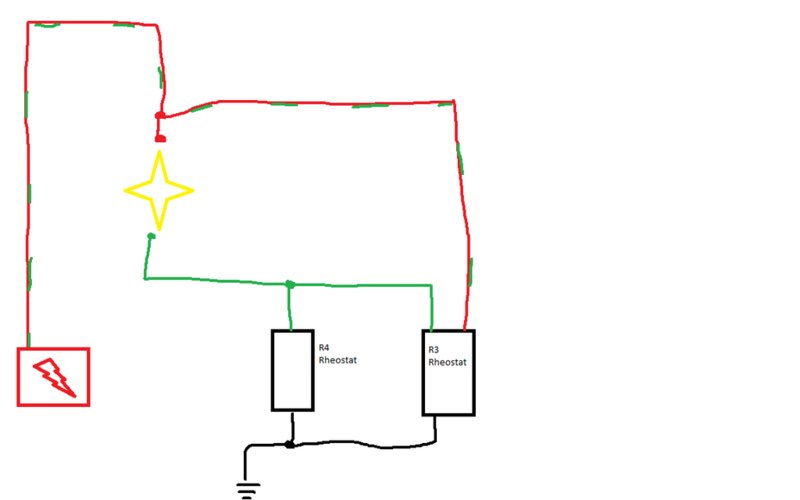

    Here is a 'dumbed down' version of the wiring diagram (Manual). I think it shows better the Dimmer wires you are looking at (R4) and why there are only 2 coming out. You need to find the G-R wire for the Lighting Positive and the W-G for Lighting Ground.

    That makes since there has to be another wire I'm not finding! I'll look again.

    IMG_20150731_180511_792.jpg there is my connector off the back of the dimmer. Two wires that fucking it!! And u can c the end of the dimmer at the top of the pic, no more wires.... The other connector in the pic is one that just hangs out up in there. It comes from the clutch start cancel switch.

    '06 SR5 Off Road
    2 wires is correct in that dimmer.
    Is there a dimmed light in that clutch switch? If so that's the G-R wire you need! Test light between your blue wite and that G-R.

    YEEESSSSSSS!!!! Success!! Put a needle through my illumination wire to clip my light to, then put the end of my test light into that empty connector at the G-R wire and bam! Proper dimming!!!!
    I still don't get how the dash lights dim right without that G-R wire not connected directly to the dimmer...
