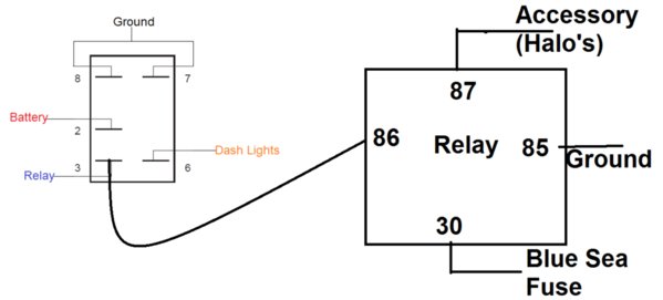

    Hey skygear quick question. Been brainstorming the setup and how I'm going to wire my switches. Have you wired any otrattw switches?
    I have this diagram that helps me figure things out. My question is the pin for the battery. That long red wire for always hot be setup for this?

    Yep. Wired plenty.
    Yes to the battery. Or use the thinner red wire for ignition on. Then just tap the 12v cigarette lighter fuse with an add a fuse/fuse tap

    Well like in the pic 6 is for the dash lights for the add a fuse. And I was just wondering how I'd go about setting up 2

    You have to daisy chain them. Use those soldering skills ;)

    Exactly. I offer daisy chained harnesses for sale. I mentioned it in one of these pages. Need to go through and re organize this op
