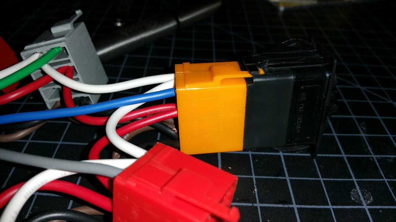

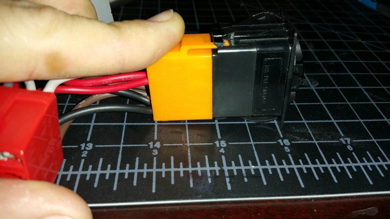

    Uh oh, how much room is behind Iggy's center console switch board....would I have to cut out the entire back for these, or would these fit just fine?

    You should have enough room. I'm not running this setup but I was nowhere near short on room

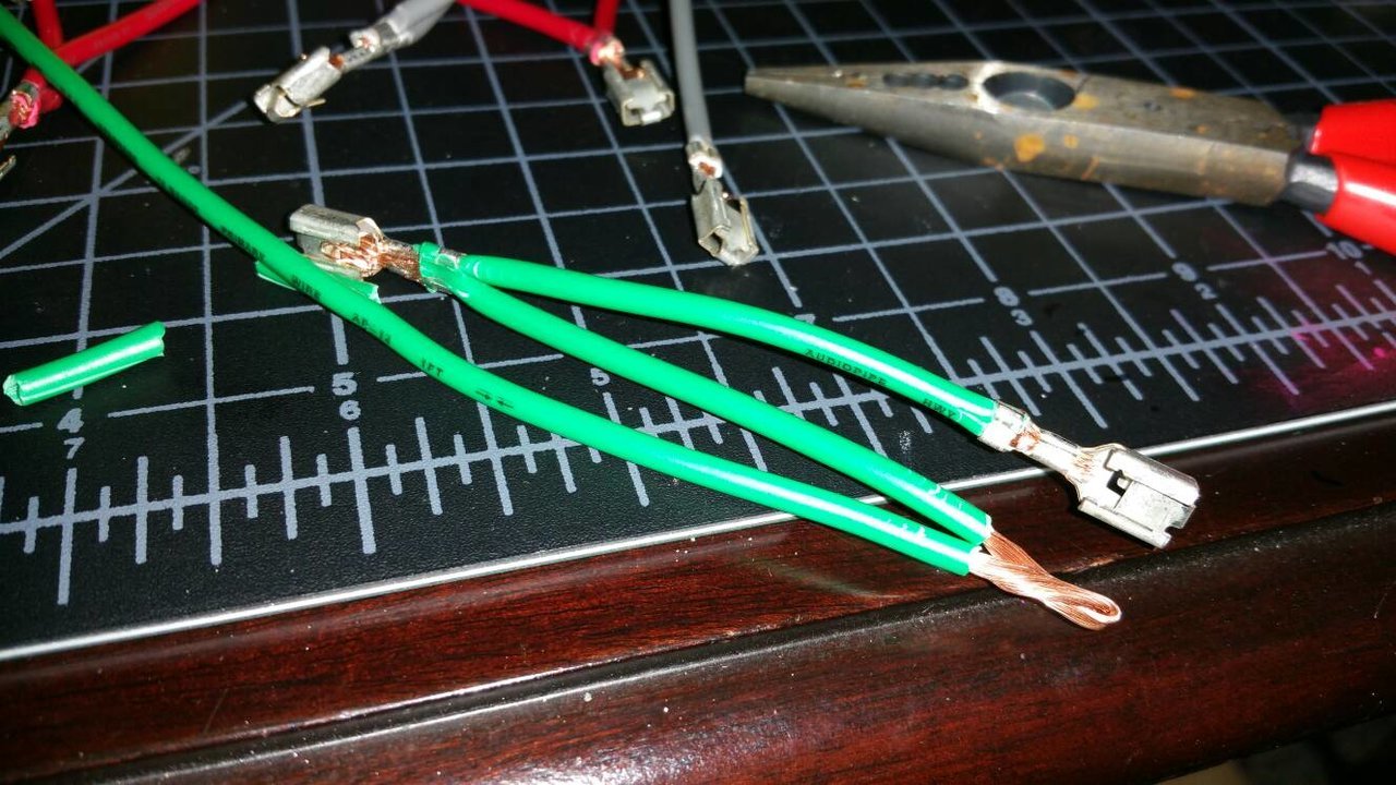

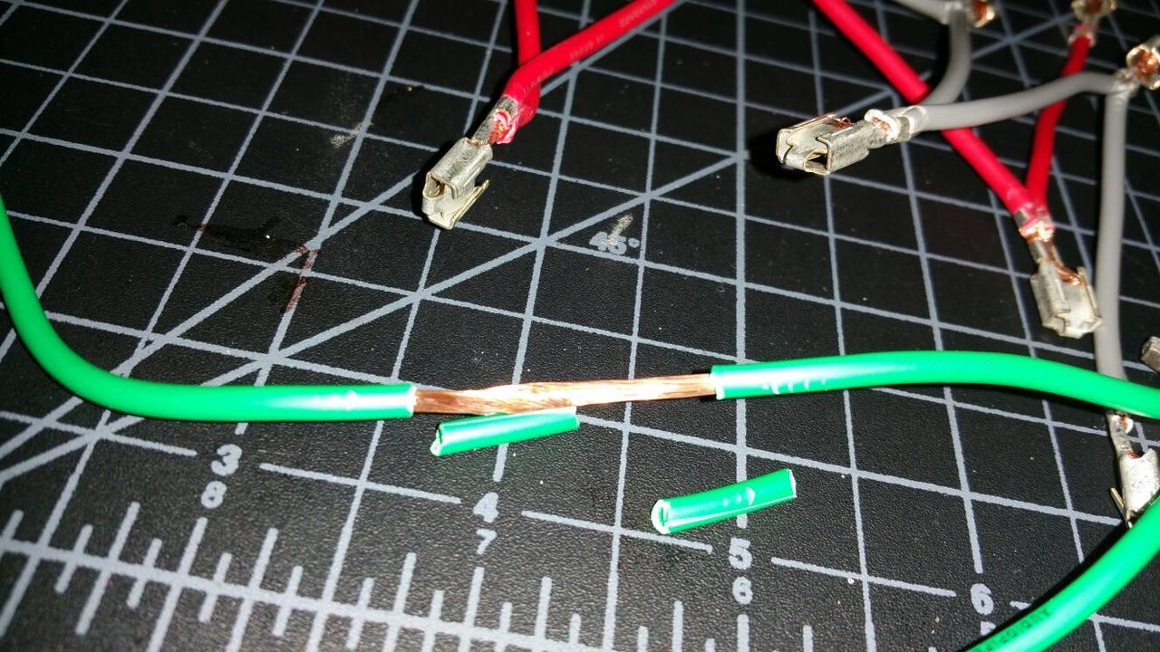

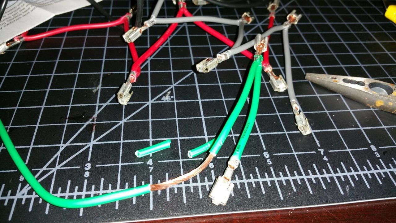

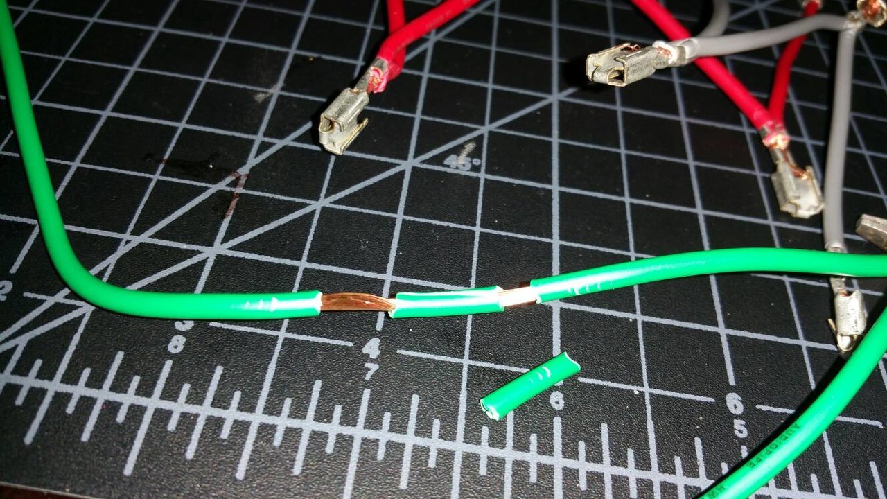

    Hey. How did you strip the insulation inline? Knife?
    I've always just cut the wire then twisted together soldered and stuck in a connection

    I use my Klein Auto Wire strippers to 'span' the wire, then a razor to remove the pieces.
    On your method. If you have the proper crimpers and they are used in an appropriate manner. The Soldering is an unnecessary measure. In an application like AV, maybe. On these 12v systems, completely unnecessary.
    I offer the soldering of the connectors if people insist on it. But it does get costly. $0.50-$1.00 additional per connection unless some flat rate is agreed on.

    With this picture above, you can gauge the depth of the overall switch and back.
    With the switch only, you have about a 1.5" area you need for mounting.
    The back only adds .5". The housing is 1" overall length. For a total of 2" for the back and switch
    I do not have one of the switch plates. Might have to contact iggy to get one for measurements.
