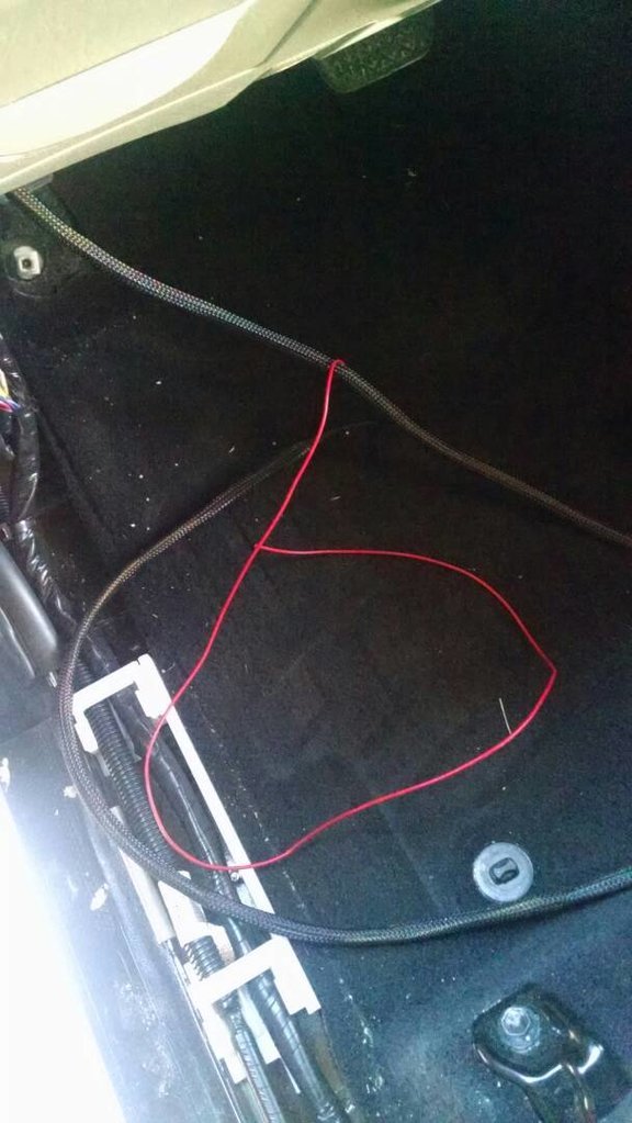

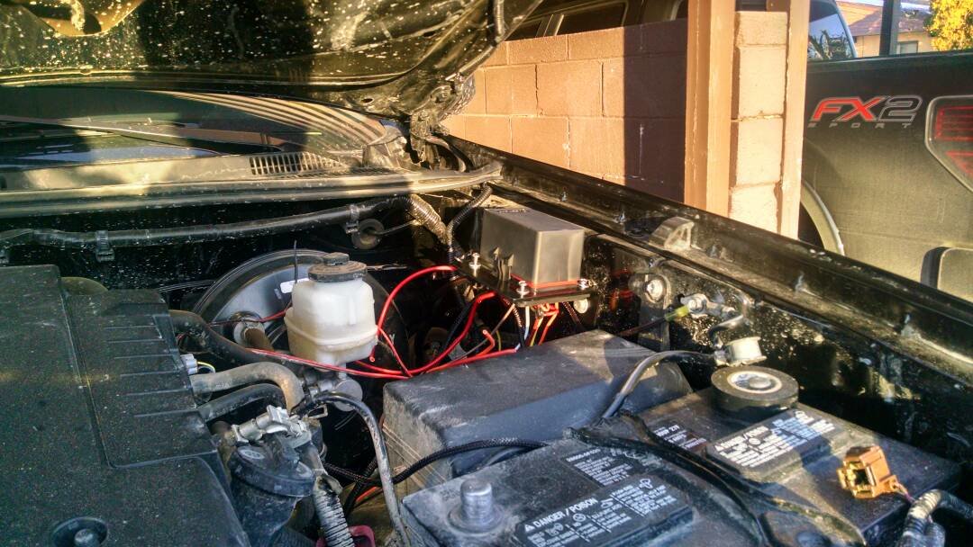

    Ok so started removing the old headlights and installing the fuse box and panel and running wires920f237aee2c9b35f27c739420e7702a_4fe4cfd1644b0e986d39329fbea94d5c36f7f2fd.jpg
    Also skygear what do I tap or should I tap for the red wire ↓11aceb479df038384e461a71e58e6aa9_ae314cde8c84999da6c9b43f121e48c9978129ea.jpg

    That wire is if you want to have ignition on power for the switches. Depending on the model year, you use a fuse tap/ add a fuse and tap into your 12v acc/ cigarette lighter.

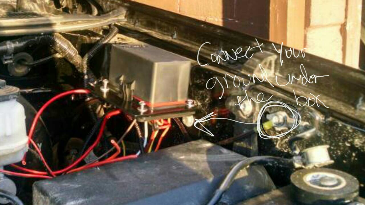

  13. Jan 25, 2015 at 4:33 PM

    I'll do that, but what's wrong where it's at?

    Absolutely nothing. I just think it looks cleaner under the box. Show as little as possible.

    Just being curious. So I use an add a fuse for the red wire. So which wire do in use to connect to the switches for the ignition power?

    The skinny red wire, 18 gauge. The 14 gauge is fused constant hot.
