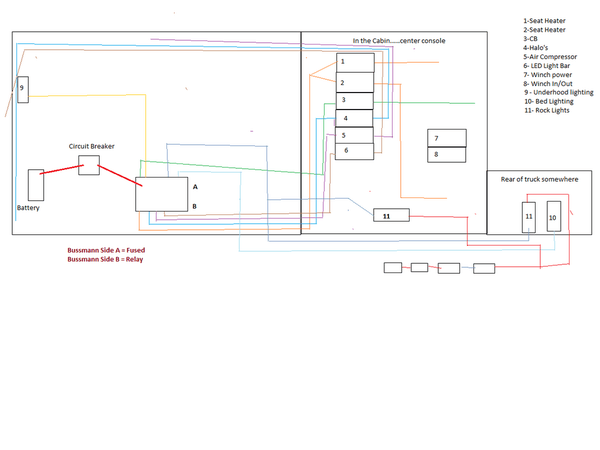

    Well its time i worked on my wiring. Thinking of getting the 5 relay version. Mostly just for the on with ignition benefits.
    But i came up with how i think i would wire it all up. Includes where the switches would be and also what they are. Using the iggy 6 switch holder and then a 2 switch holder ill cut into the center console. All switches are otrattw for the most part.
    The random lines that go know where are just for my own reference of where the "to acc" wire would be ran (approximately)
    Each switch is labeled with what it is for. Most are pretty basic. But i do have some questions.
    1) For switch 1 and 2 i thought i could use the same relay to power both. It would be for two seat heaters (wet oakle ones). Best i could find each heater uses 4.5amps. Im betting most of the time it would just be there drivers side being used as i dont usually have a passenger. But 10 amps (saying 5amps just to be safe) is only half of what the 20amp relay can put out so seems like it would be ok?
    2) Circuit breaker....not so much a question but rather i want one just for a "master on/off". I sometimes leave the truck sitting for awhile and its just a comfort to know i can just have no power to anything but flipping the breaker.
    3) The rock lights. I hope that my idea for the wiring works. basically i would like a switch in the cab and also towards the rear of the truck. So my thought was to Split the wire off the fuse and have two leads...one going ot each switch. Then on the "to acc" side of the switch have them meet up at the first rock light and have them combine back to 1 wire and then that one wire connects to the rock lights. Good idea? bad idea? wont work?
    4) Switch7 and 8. THe winch stuff i dont think would hook up to the bussmann at all. Its a bit complicated and i need to look into it a lot more but dont think it really has to do with this thread or the bussman. But basic idea is the power switch powers the actual On-Off-On (in and out) switch so it cant be accidentally turned on. Id probably do winch power on the iggy and the control on the console
    Anyways am i missing anything or does it all look good?
