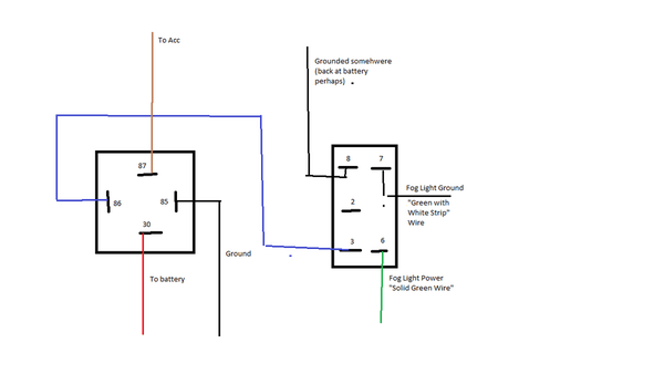

    I think you would want the heated seats on their own relays. As you have laid it out both seats would start heating when either of the switches are on. I don't see any issue with the amperage, just the functionality. One relay would have no way of isolating the voltage to the driver and passenger seats.

    delete my way off understanding stuff :)
    *edit*
    Actually now that I have looked into things a bit more I understand what you were saying Up. Ive never used a relay before so was a bit confused. But I do see how my orginal idea of one relay wouldn't work
    The relay to switch and everything wiring would look something like this
    On the OTRATTW switches where do people get power for Pin 2 (incoming from fused source)? Just tap into a only on with ignition fuse? (add a tap)

    To be honest I had the OEM setup in mind when replying. If your aftermarket switches that control the heated seats can safely handle that kind of current then there would be a way to make them both work off of only 1 relay. Usually a relay is used because the switch can't handle the amperage, or to avoid running larger diameter wires into the cab. The wire size wouldn't be so much of a concern here but the switch rating may be.

    The OTRATTW switches are rated for 20a 12v. So they should work.
    Even so I think using a relay for each might be simpler and easier.

    Looks like you got it now. You could run each heated seat on its own relay, or if you are comfortable funning the full amperage through the switches then you could just run each of them from a fused source and not use up any relays for the task. Skygears box would easily allow for either option.
    As far as an incoming fused source for the switch are you looking to get one of skygears boxes? If so I believe he incorporates a fused lead for switches (don't have a box myself but looking into one for when he takes more orders). If not then yes as you say you would use an add a fuse tapped into accessory switched power source from your fuse box.
