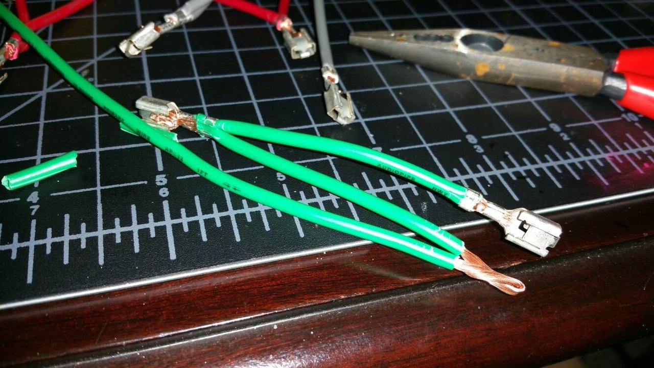

    Hey man can you post a little video on how to crimp packard 630? I keep jacking my terminals up :/.

    Yes. What die are you using? Gauge wire?

    I am using 18922 die from the tool aid crimper. I am trying to crimp 14 gauge wire.
    Trying to do this

    Ok trying to video now.
