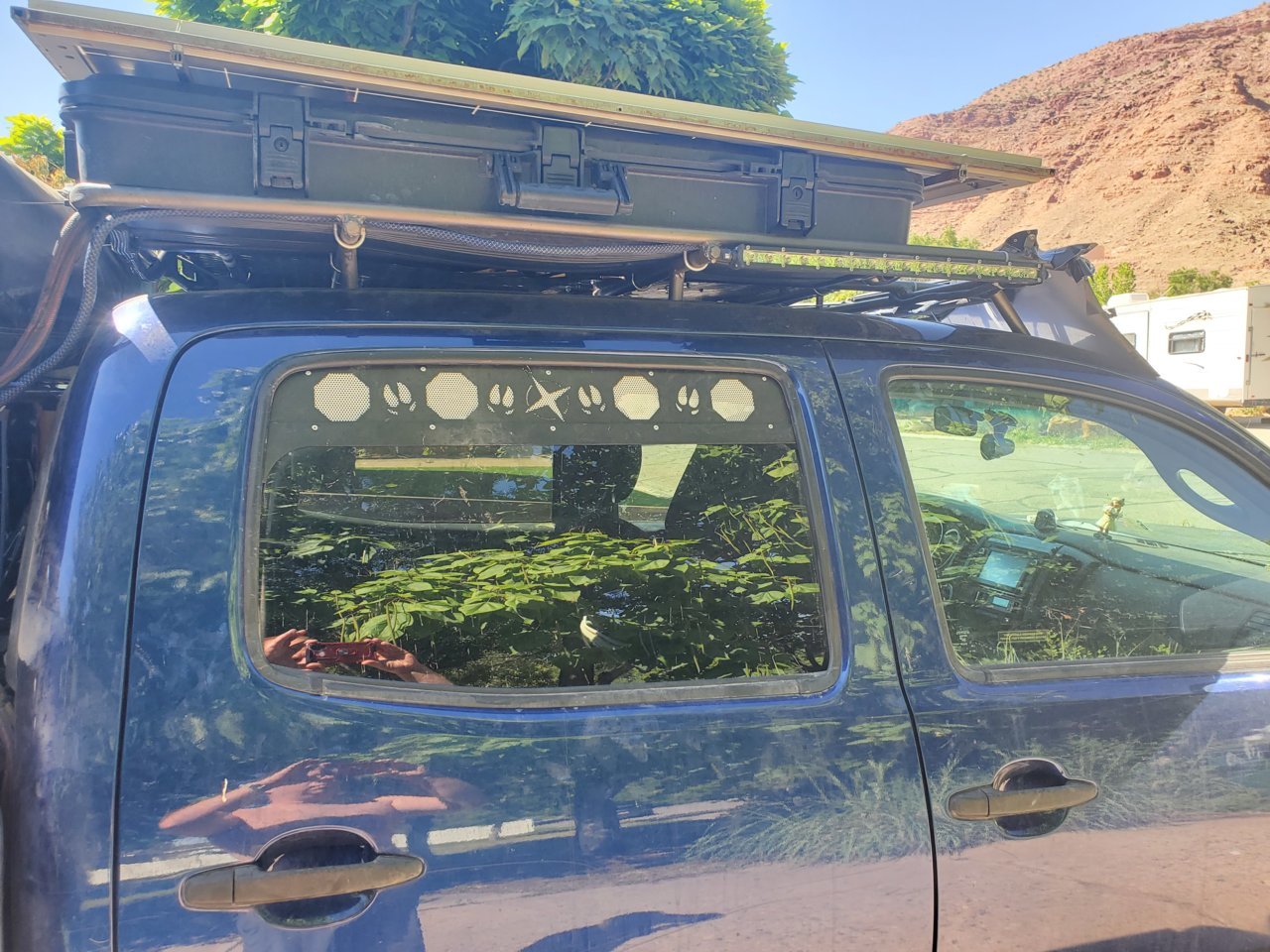

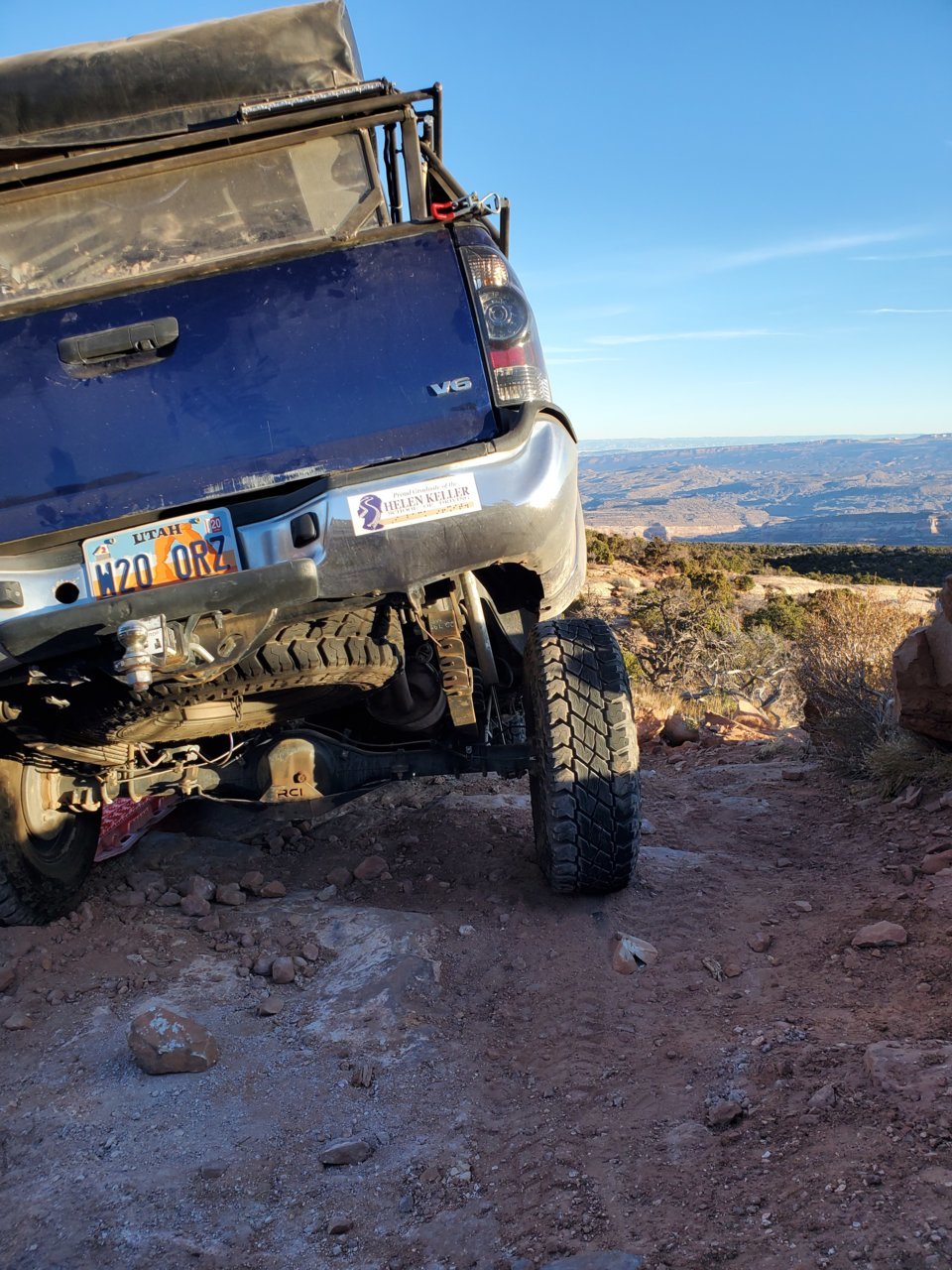

    Did a few things and took a quick trip down to Alstrom Point.
    Added custom trail vents from @Yo_Hec Ended up looking way better than I expected and help keep the truck temps down in the Utah desert; very happy with them.
    Added side power panel to accept the new flexible solar panels. Wired up solar inputs, still need to wire the AC side and air as well as securing it to the truck a little better.
    Other than being stupidly hot, it was a great chance to play, hang out in a portable slice of heaven, and take in the views.

    Peddle commander and various molle racks.
    Hysterical, i didnt know you had a pig!!! I was wondering what hooves those were cause they didnt look like deer to me. :)

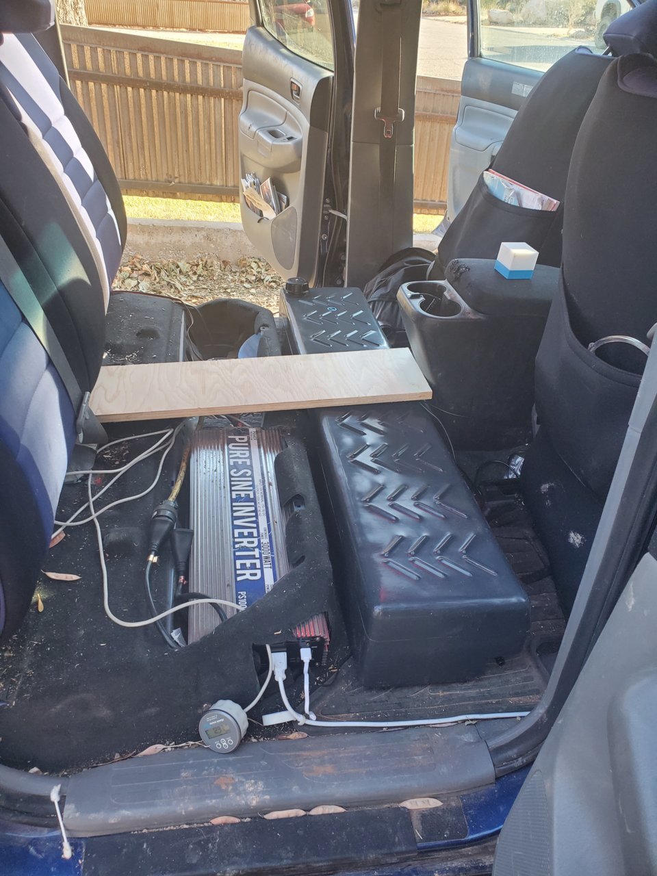

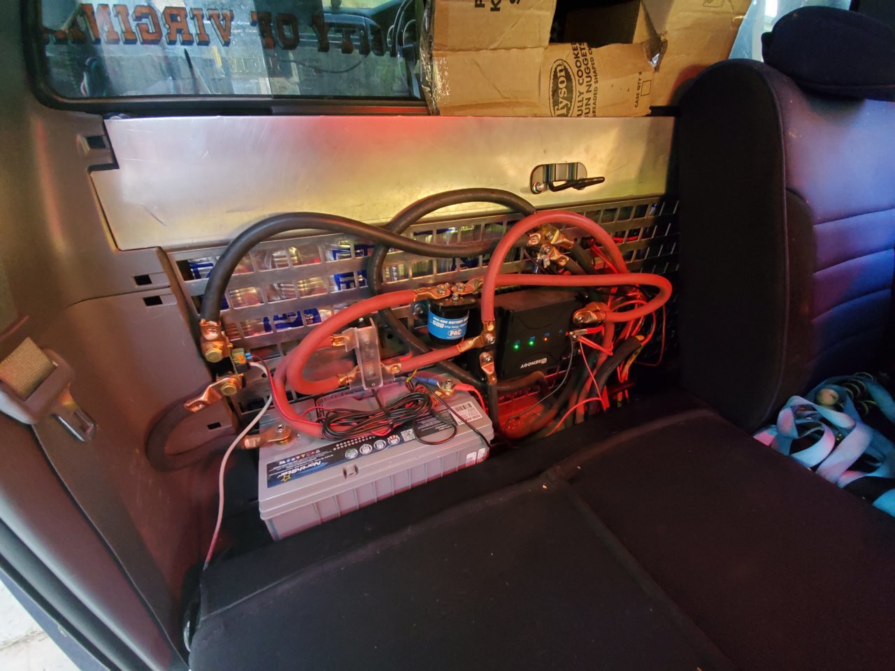

    Behind passenger's rear seatback.
    Most of the big electrical items for the house electrical (DCC50S, house battery, fuse, bypass solenoid) are behind or under (inverter) the rear passenger's side seat (60% split). Once you pull the cubbies there's a lot of room back there: can replace with a molle panel and sound deadening or simply a plywood backer panel. Most external wiring is run through an existing hole under the seat midline ~10" from the rear wall.
    Air flow could be improved, but the only times I routinely see system temps in the 110F range is with ambients >100F.
    Driver's side currently has the AC battery charger and will contain the AC subsystem as I build that out.

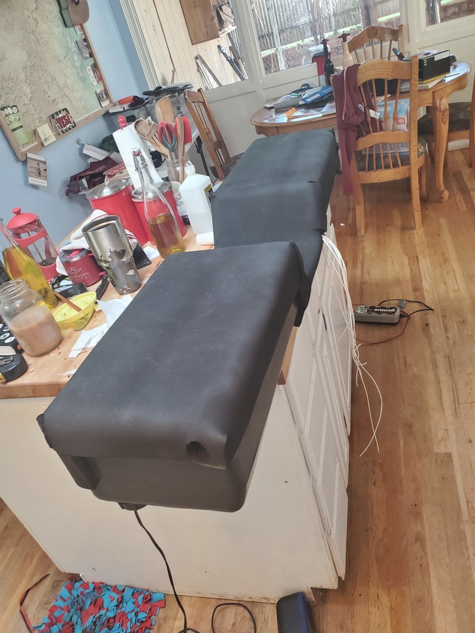

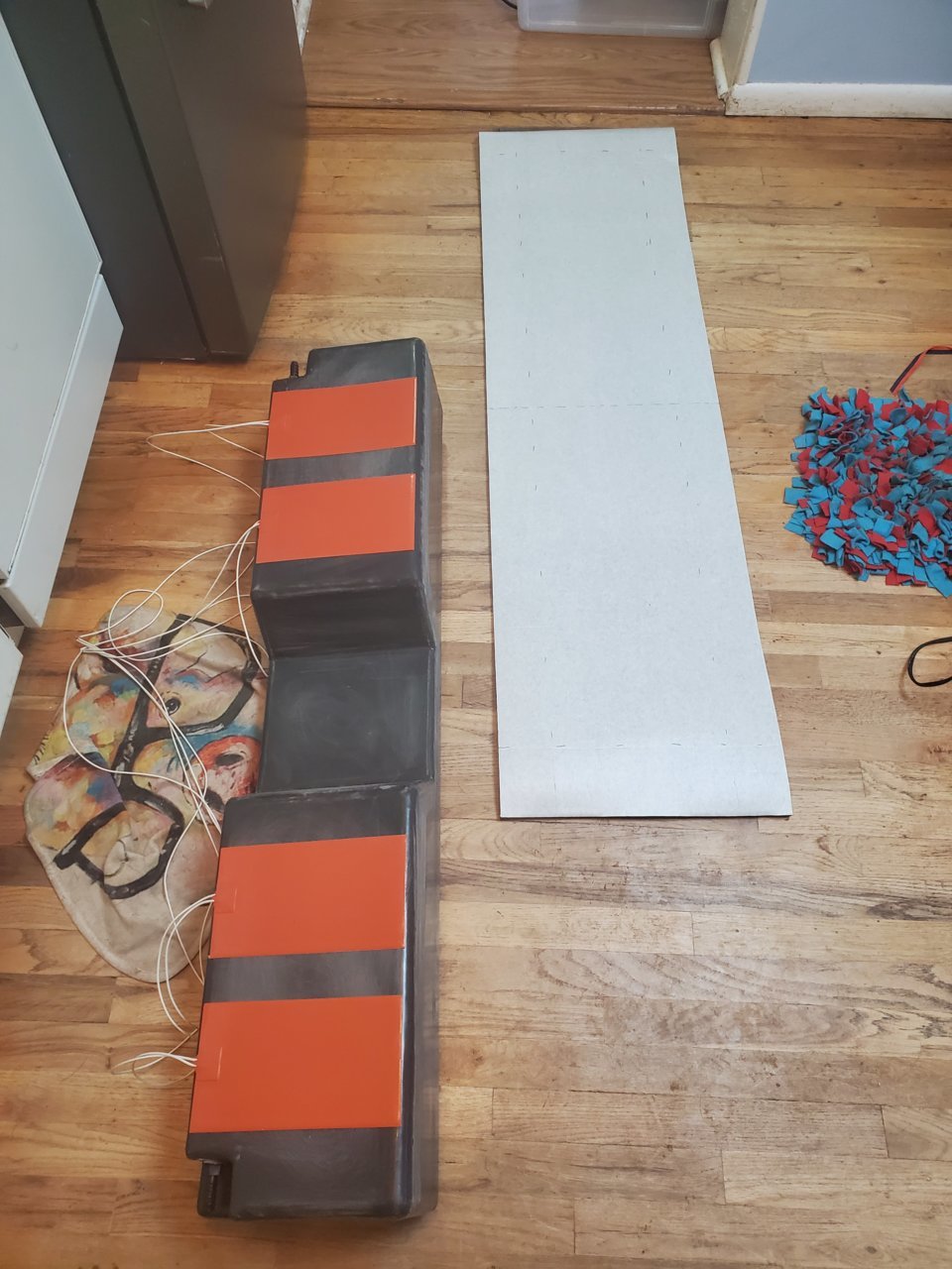

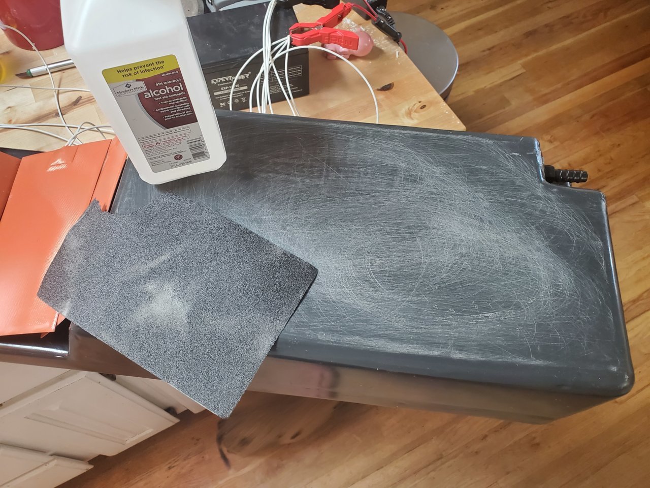

    On the build side: first iteration of a heated water tank.
    The tank itself is a Frontrunner foot well tank (WTAN022). This holds ~10 gallons and fits in the footwell of the rear seat. With the pig platform this space was hard to access, so it was an easy choice to fill it.
    Living in the desert, we have 2 water issues. In the summer, we need to carry a lot of water. In the winter, overnights are in the single digits and, when water tanks live on the truck, they will (and have) frozen solid. Because of this we added insulation and heating pads to the bottom of the tanks.
    Prepping the tank surface.
    Installing the heater pads.
    Wrapped in neoprene.
    The four 15W heating elements are run through a W1209 thermostat module controller ($10 for 2 on Amazon) which kicks the heaters on when the temp is below 3 C and turns them off when it reaches 6 C.
    This iteration has a simple cross-over with tubing and a ball valve.
    The good:
    - Main tank no longer freezes.
    The bad:
    - The uninsulated crossover tubing freezes.
    - Because of the tank design, I can run out of water on the passenger side while there is still water on the driver's side.
    - Currently fill is manual pour from the driver's side. Not a huge inconvenience, but I'm clumsy and high spill potential and multiple trips.
    Future changes:
    - Insulated and heated lines. Ultimately there will be lines run to the front and rear of the vehicle as well. We'll be running multiple temperature inputs through an Arduino to control multiple heating zones (we've been looking for an excuse to play with Arduino for a while).
    - Crossover improvements. 1 way valve to prevent losing the siphon on the line, +/- a pump to make sure we get full capacity
    - Pump and filter. Pump to allow pressurized water supply and drafting to fill. Filter both to allow filling from questionable water and, more practically, to improve water taste.
