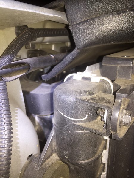

    This has a forced air cowl that goes behind th grill and stretches all the way across between radiator and hood.

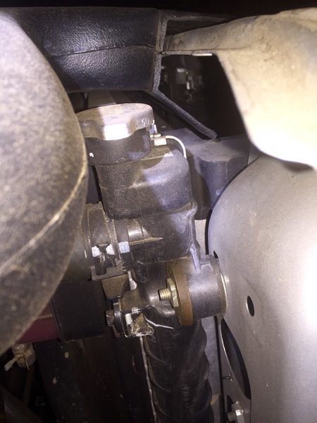

    The inlet is about 4", top to bottom. It reaches down from above the rad and dips just in front of it. The inlet shrinks to 2" wide before heading to the massive filter box. The air scoop is 24" wide. I took my tape measure out to check 5 minutes ago.

    Nope:
