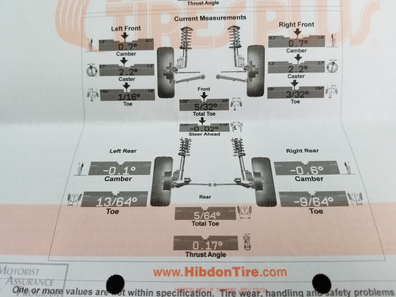

    Did the Billy 1.75" front end lift about a year ago. Now I got some wavy inside tire wear. Kind like a mountain range. Drawing a blank on what it's called. Steering wobble little worse too.
    Anyway, think alignment is the cause? #'s attached. Had tires balanced twice and rotated, doing it to all of them. Balance was done right after the lift.

    So I read my toe and camber should be around 0. That sound right?

    That alignment is good, zero camber is bad on Tacos' they need positive or will have inside wear. The toe is close to zero anyway, but I prefer it to be a touch positive. I like your alignment.
    The cupping can be from the harsh spring rate from the preloaded springs.
    It can also be due to the nature of the tire, LT tires (assumed here) like weight, and need to be rotated like crazy on our lighter trucks.
    Consider rotating in a diagonal cross to encourage better wear, you reverse the feathering and cupping by reversing the rotation.

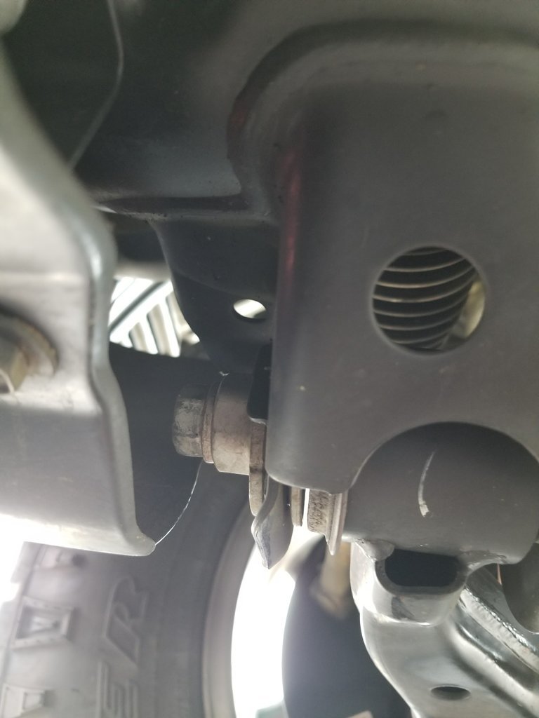

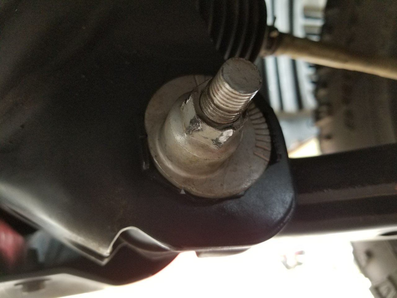

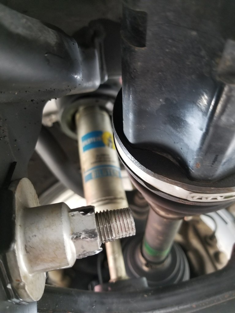

    Ok, so i went to a different alignment shop today and they were going to adjust the camber back to 0, but broke a snap on socket trying to loosen one of the camber nuts, rounding the nut in the process, see pic. They thought that Hibdon's may have over torqued it when they aligned it or its seized. Seems weird a 2013 with no visible rust would be seized. Oklahoma truck too. We decided to leave it since it was still in spec and didnt want to make it worse.
    Question, should they be loosening it from the nut side or the bolt side? I thought i read once, loosen from the bolt end, but i'm probably remembering something else, what you guys think?
    Also, you think a week of daily PB treatments and hammer taps will loosen it enough to be able to get it off? Maybe with one of those extractor sockets? Dont really want to f it up, seeing its in spec, or so they say.
    Added pic of front of bolt too. Thanks as always guys!

    Wtf u can't turn the caster adjuster to loosen the adjuster lol. U should get them to fix it. U can only turn the screw side to loosen it...(the second picture) and if they can't move it they probably didn't lossen enough to let the adjust turn.

    So they should have been loosening it from the front? Pic with skid plate in front of it? I was worried about that. They were able to loosen the back on the others.

    :facepalm: If the guy aligning your vehicle doesn't even know how to properly loosen the adjusters...you're better off without him.
    You can just loosen the adjuster the proper way and probably not have to replace the whole thing, but they SHOULD fix their fuck up.

    Yes the skid side.
