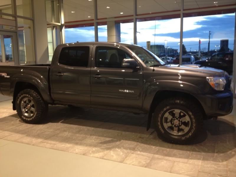

    ^^ That's Nice!! Did the dealership offer it with the FJ wheels?

    Nope. Those came off my 2010. The dealer wasn't too happy bout that one. I made them switch around the tires and rims with the new truck before I'd sign anything :)
