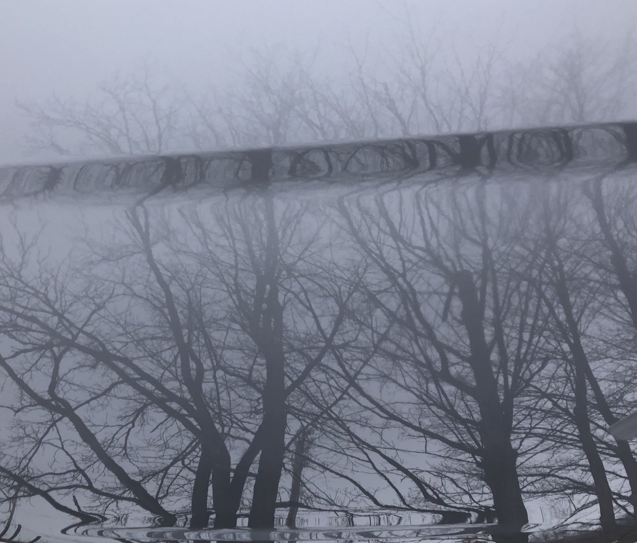

    Use a sealant and let it bond. Then use a black wax, it’s literally black or dark grey if you can find it. Ceramic is good too but imo wax or sealant gives you peace of mind if regularly used a few times annually. Biggest thing is use a two bucket system. Don’t wash your paint with the same stuff you use to clean your rims and undercarriage. Have a paint specific bucket, if you drop the mitt, don’t touch your paint with it. If you drop your clay, don’t touch your paint with it. Don’t use a car wash either, unless it touchless! This is the paint on my hood..
