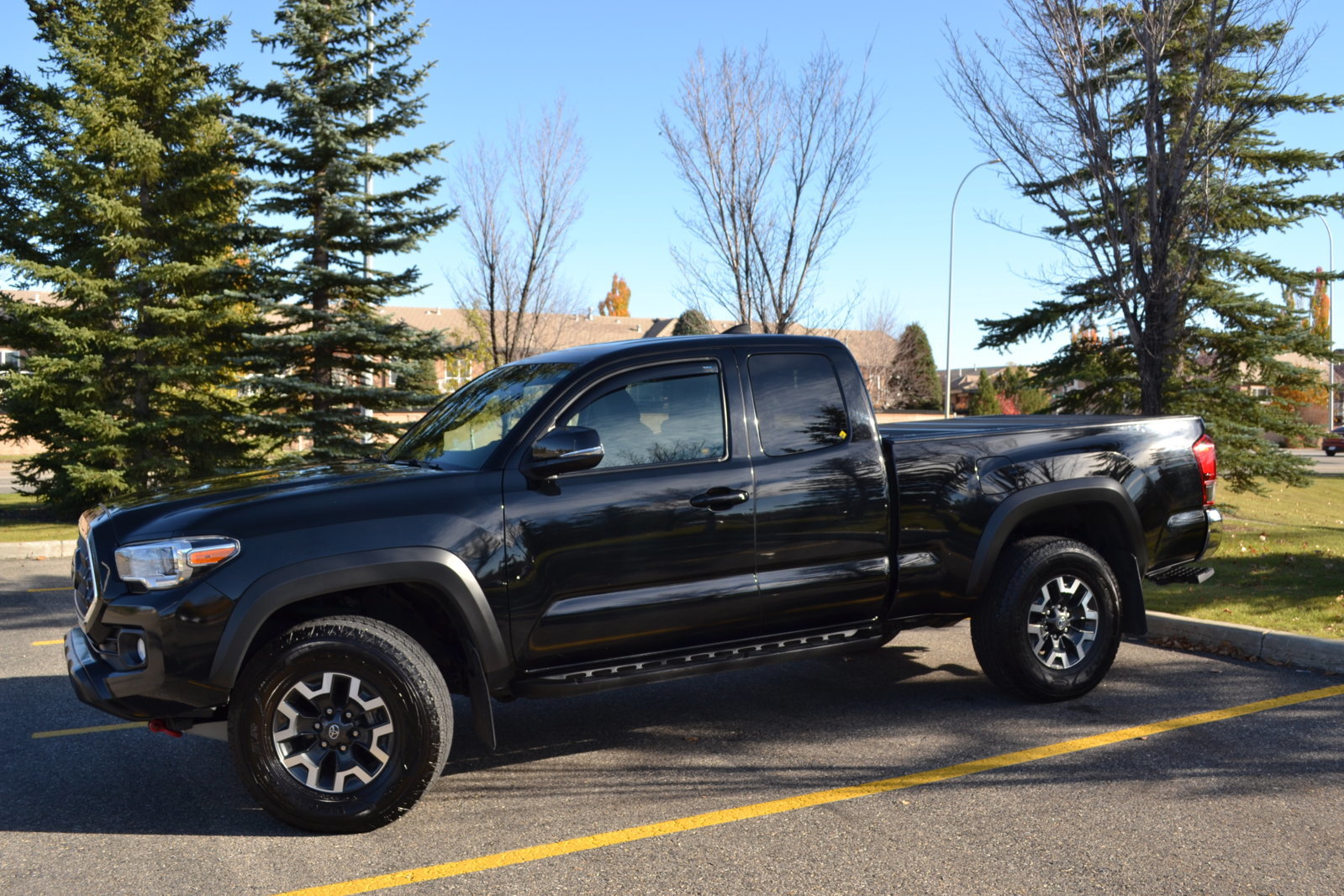

    WHY? I always do classic carnauba wax and ceramic spray on top. Nothing wrong with my BLACK truck, period.DSC_0367.jpg

    Ceramic protection is superior to carnuba wax for pure protection of paint. Not taking shots at carnuba wax as it definitely gives a deep warm gloss that is preferred by some over ceramics cool gloss. But there’s no comparison in protection and longevity as professionally applied ceramic coatings come out on top by a long shot.
    With that said, you always want to put a ceramic coating on a prepped and cleaned surface with nothing between it and the clear coat for maximum protection and gloss.
    This is not something I’m spitballing but is industry standard in professional detailing.
    At the end of the day any protection applied to paint is ahead of the game…
    Also, do your own homework and don’t trust some guy on a forum!!

    Oh, I see... I forgot to mark boundary between ceramic coat and ceramic spray , sorry.
    Ceramic coat need to be applied only on prepped and cleaned surface, professional application highly recommended (90% probability of screw up surface without proper training,
    skills and experience) It lasts up to 5 years, and cost of application is high (over 1000 CAD in my area). Contact with glass, plastics and rubber are not recommended.
    Ceramic spray can be applied like super finish on the top of most waxes and sealants, can be applied in layers, can go over plastics, rubbers and glass. Easy to work with,
    nice DIY project, affordable cost (1l. bottle for 2 vehicles is 80 CAD and enough for 40 applications) But protective effect lasts only about 6 months (fully exposed to UV and elements and up to 9 months with garage use), that's why I do coat my vehicles at least 2 times a year, at fall and at spring.
    On my truck's horizontal surfaces exposed to UV and elements (roof and hood) I usually applying compound paint sealant first, carnauba wax second and double or triple layer of
    ceramic spray on top. The rest of the body - just ceramic spray over the cleaned surface.
    To me for last 6 years it's best balance between cost, labor and finish result.
    And yes, G-Technique ceramic spray - that's what I'm using.
    Highly recommend!
