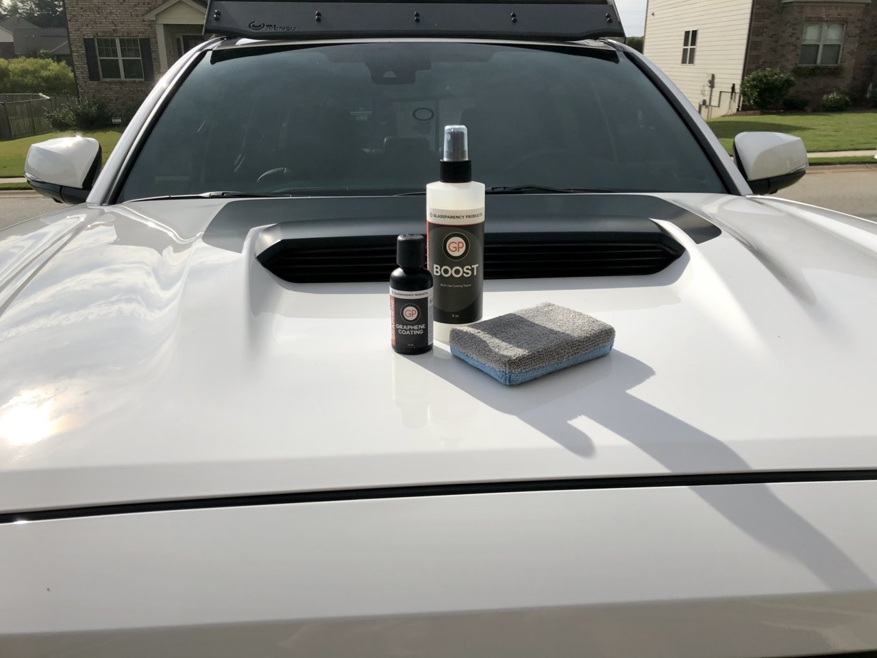

    You may want to consider doing a ceramic or graphene coating. I bought a 2020 a few weeks ago and one of the first things I did was to clay and do a graphene coating.
