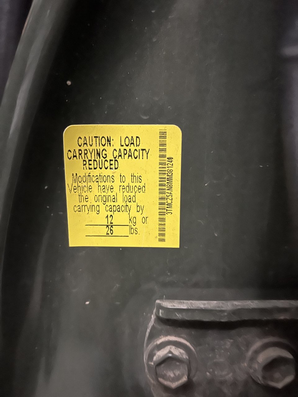

    I just took some pics of the door stickers and I noticed this sticker, which is new. Anyone get one of these before? Also, when calculating my trucks payload I need to add the following: heavier bumpers, skid plates, winch, roof rack and the box full of recovery gear and tools and what about the upgraded suspension? Isn’t it heavier than stock components?

    The yellow sticker indicated a port added option like tube steps, bed mat, etc.. I believe they even put one on for the added tailgate letters.
    And yes, all your bumpers, skids, recovery gear, people, dogs, tools, bikes, lunch all go against your payload.
