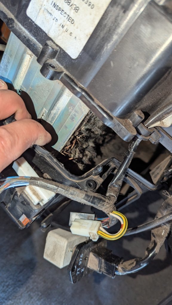

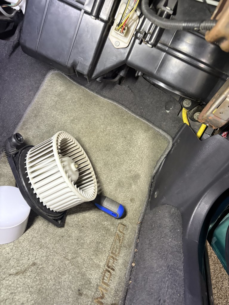

  5. Jun 14, 2025 at 12:14 PM
    hapax1
    hapax1 [OP] Active Member
    Feb 22, 2024
    #444428
    34

  9. Jun 16, 2025 at 7:45 PM
    ControlCar
    ControlCar My Moto: Help & Learn…period.
    Jul 22, 2023
    #429578
    3,343
    Steven
    Sugar Land TX
    1996 Taco 2.4L 2wd Automatic
    Clock Volt meter/LSPV Delete/Hyundai 16’s/FP gauge/after 9months of wrenching ZERO oil leaks
    Ugh^^^so true
  10. Jun 16, 2025 at 7:56 PM
    ControlCar
    Jul 22, 2023
    #429578
    3,343
    Steven
    Sugar Land TX
    awesome fix!
    So vid explained but didn’t show crap
    you dropped the lwr section of evap box?
    Like at an angle?
    PiTA to get entire bottom cover off?
    Just as long as bottom partially dropped, that gives u enough access to clean/vacuum?
    thanks
