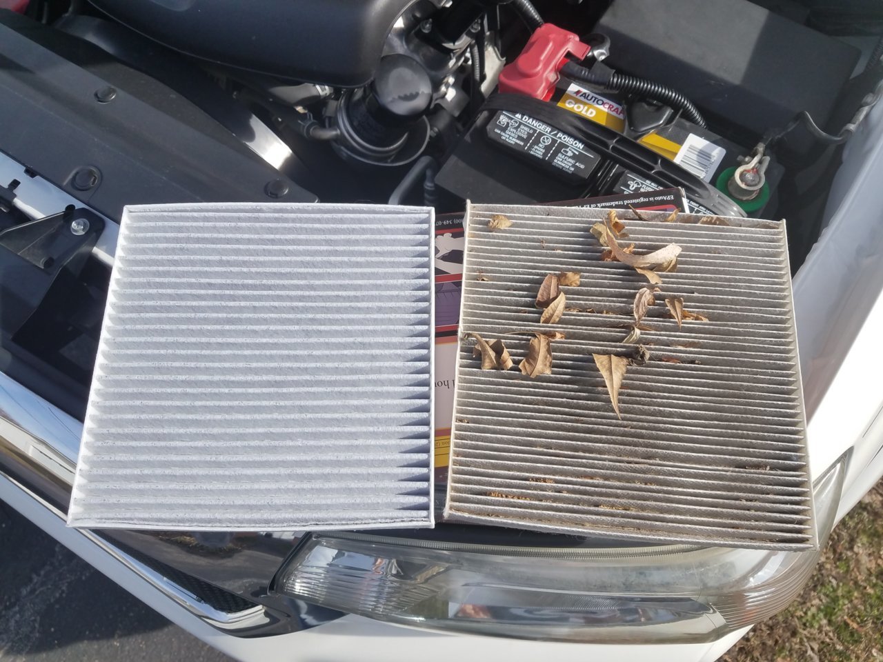

  16. Jan 21, 2020 at 5:34 AM
    #36
    Dergibog
    Dergibog [OP] Well-Known Member
    May 26, 2017
    #219953
    66
    Coldest day of the year yesterday. Minus teens for the wind chills. First drive after changing the cabin filter and that made a noticeable difference. I thought it was my imagination but I asked my mechanic if the cabin filter can make a difference and he said yes. I really don't see how. I guess air must pass thru the filter, even on recirc? I assumed it was just incoming make-up air that passed thru the filter. In for service today and they are going look at other ways to improve heat.
    redcon likes this.
  17. Jan 21, 2020 at 10:10 AM
    #37
    redcon
    redcon Well-Known Member
    May 6, 2017
    #218362
    228
    Dave
    Southern PA
    2012 AC 4x4 Base 2.7L/5MT
    I've always though the heat was weak in my 4cyl base Access Cab. I guess I need to check the cabin air filter!

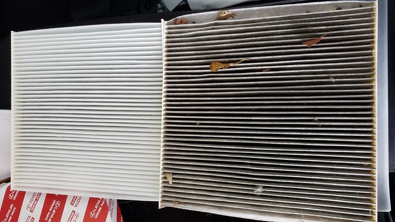

  18. Jan 22, 2020 at 3:32 PM
    #38
    jbaker1976
    jbaker1976 It's always Taco Tuesday
    Oct 18, 2019
    #308323
    272
    Jason
    East TN
    2015 DCSB OR
    Camper shell with side windoors and bed slider, JL Audio Component Door Speakers, JL Audio Stealth box, Grill Craft Grill, Husky floor liners, Hondo Radio knobs, Predator steps, Remote Start, Pop N Lock, etc...
    I replaced my cabin air filter today. I dont think they cabin filter had more than 9k or 12 months, but it sure needed it. I think my heater and airflow are a little better. I also changed the engine air filter too.
    redcon likes this.

  20. Jan 22, 2020 at 5:01 PM
    #40
    winkel
    winkel Well-Known Member
    Dec 24, 2015
    #173039
    2,632
    Corydon, IN
    2014 Spruce Mica, TRD Off-Road, 6 Spd Manual
    Sliders, Tailgate Liner
    When you buy a replacement cabin air filter, IN MY OPINION, don't buy one of the so called high efficiency ones. I bought one at Wal Mart that is thicker than the stock unit and it reduced my air flow. I won't use them in my furnace in the house either. They just block too much air and don't let the system perform like it should.
    As a test only, remove the cabin air filter for a couple of days and see how it does. Just don't run without one for too long. You'll get crap in your fan motor.
