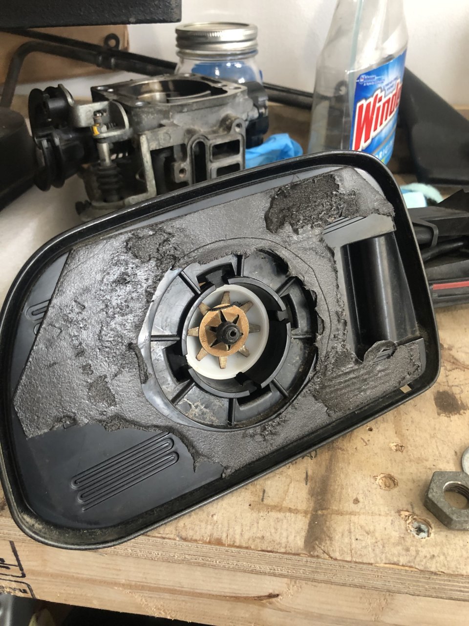

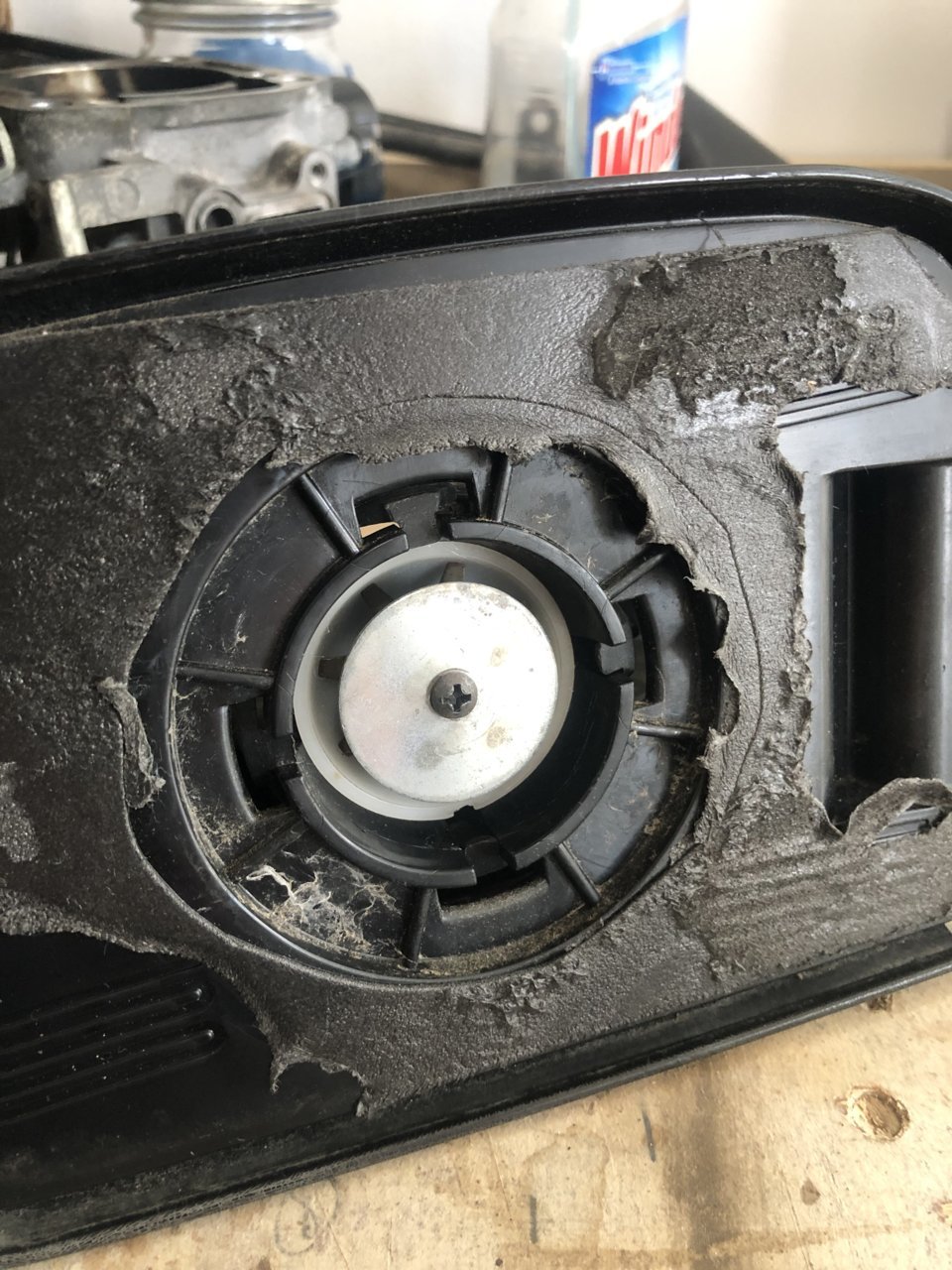

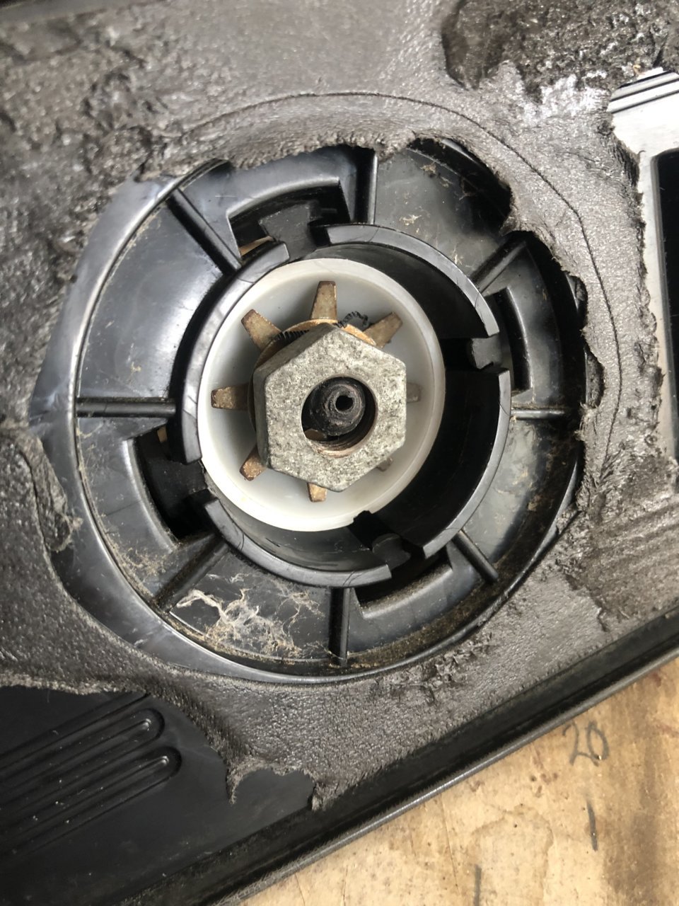

    My mirror kept dropping while driving. Didn't want to buy a new one. Had some scrap hardware laying around and free time. The nut/washer combo pressed the compression washer down into the plastic uniball. Worked perfectly! Hope this helps anyone with the same issue
