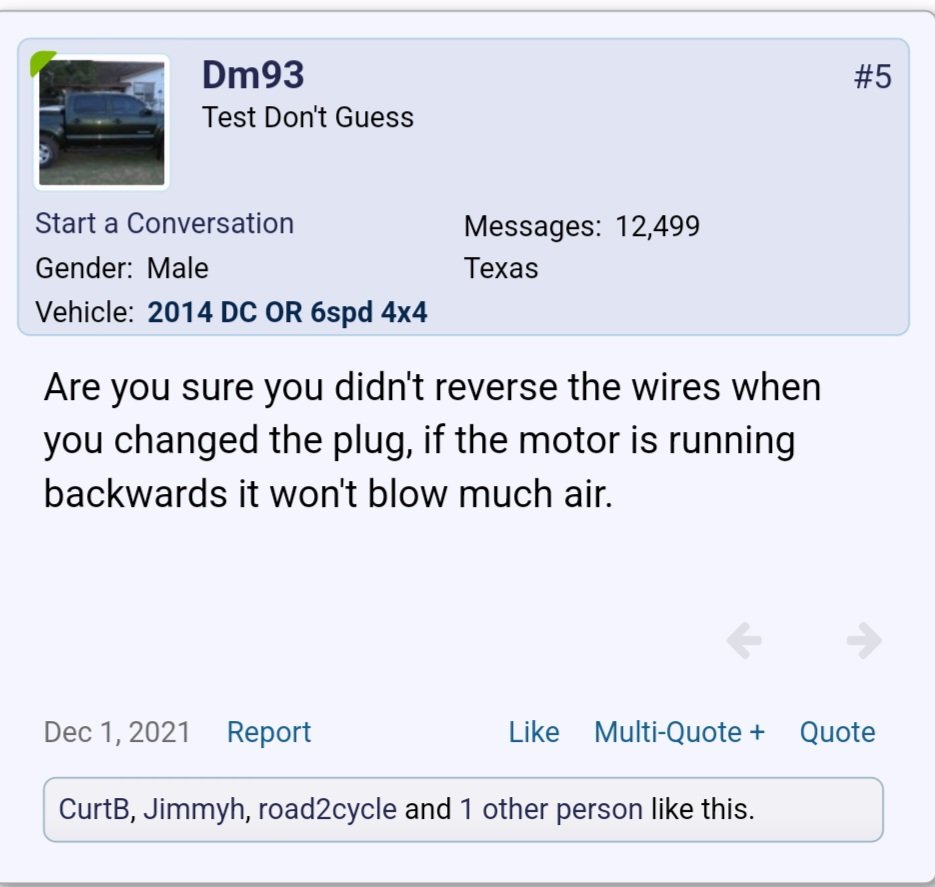

    So I was going to reply to this saying that it didn't make sense / that it only rotates in one direction.
    Whenever I dropped it, I never disassembled anything.
    However, I just stumbled onto a post in my digging and I'm pretty sure I found the issue and it's probably this.
    The new harness had different colored wires and I thought I paid enough attention to wire it correctly based on the orientation. In fact, I was very careful to pay attention to that. However, I'm guessing I messed it up.
    I suppose I'll be re-wiring it whenever I get a chance (again...*sigh* lol).
    I'll update whenever I do. But I'm betting this is it. Glad to feel like I probably have the answer now. Just wish I didn't have to do this for a third time inside a year.
