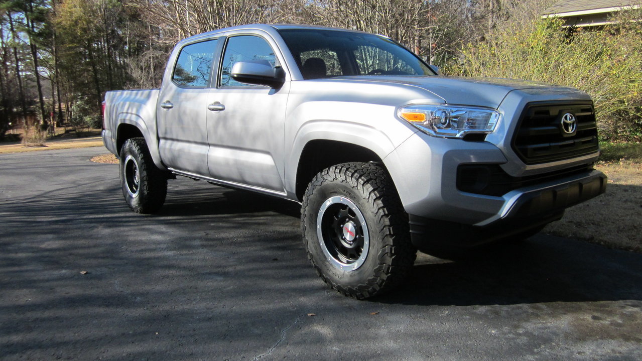

    Hello all,
    New to this site and new to owning a Toyota Tacoma. I just bought a 2017 double cab SR 4X4 and was wanting to start accessorizing it. I look at it as a blank canvas. I started with TRD wheels and BFG K02, 265/75/16 tires.
    What is the weakest link to this truck when it comes to going off road, NOT ROCK CRAWLING. I want to protect my investment and was thinking about rock sliders to protect rocker panels and/or skid plates, mud flaps, etc. No budget to do a proper lift anytiime soon.
