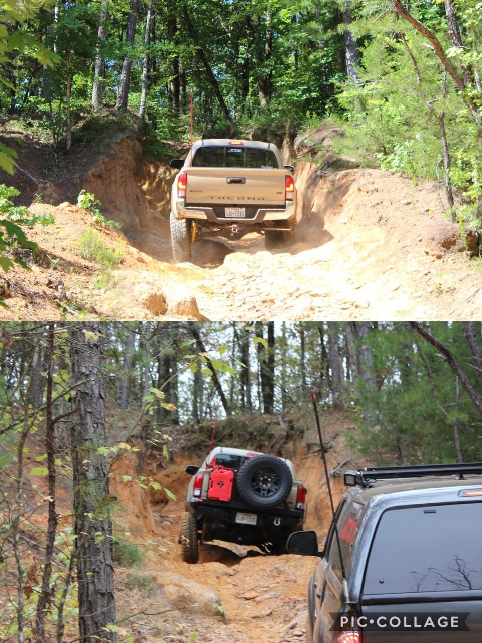

    The front skid plate is always the first thing I add to our Tacomas and it seems to be the most used piece of armor, unless you count the hitch. Sliders get added when we decide the truck might go to an OHV park or a big trip. We wait till ~30k miles for the lift and tires.
    We were in BBNP last month with our 3rd gen; drug the hitch several times, made contact with the front skid a couple of times, and the sliders were only used a steps. Ran Black Gap and a few others. On our 2nd gen I believe Black Bear is the only trail I've drug a slider on outside of OHV parks.
    If you're not Rock Crawling Aluminum Skids are a good option to keep the weight down.

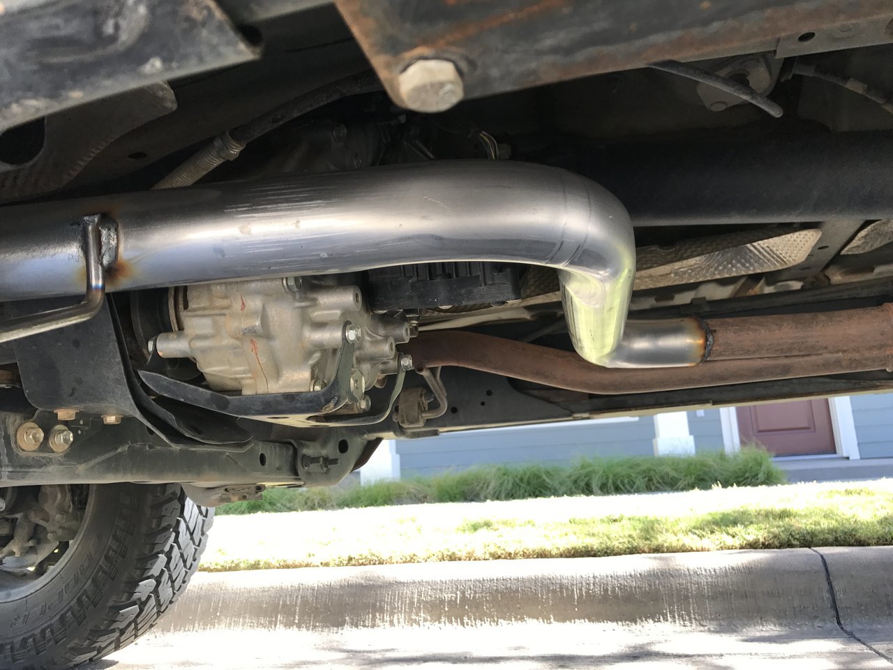

    In my opinion the exhaust crossover is the weakest link when off-roading. The reroute was one of my first mods so I could get full skids. IMG_9500.jpg
