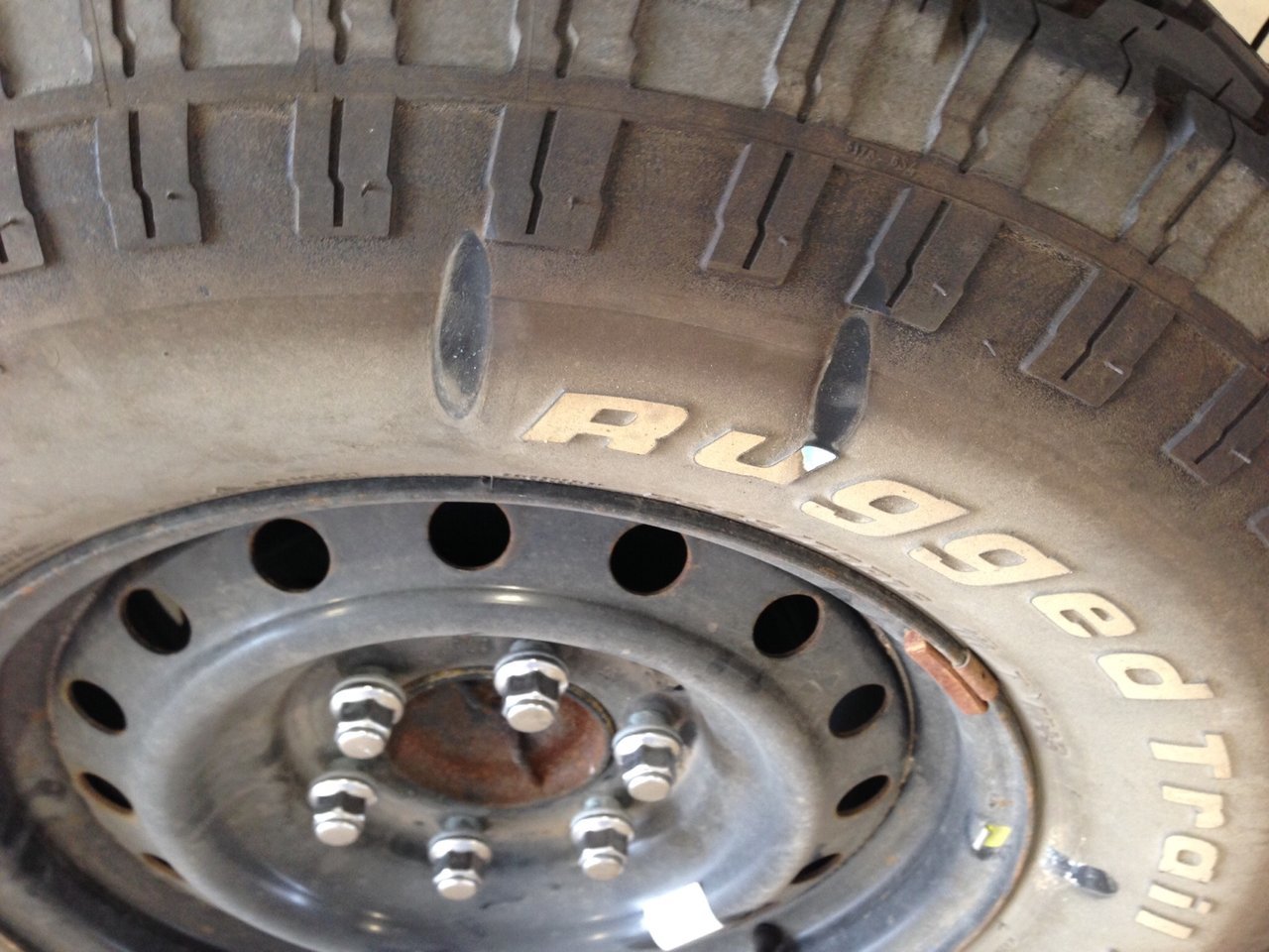

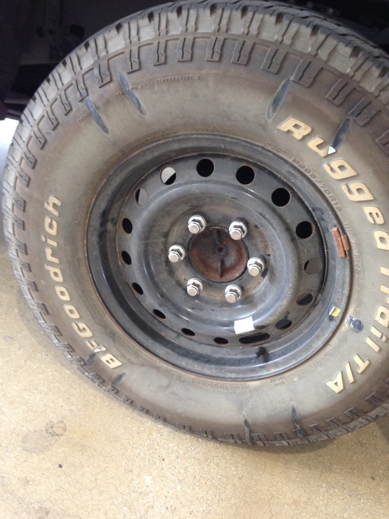

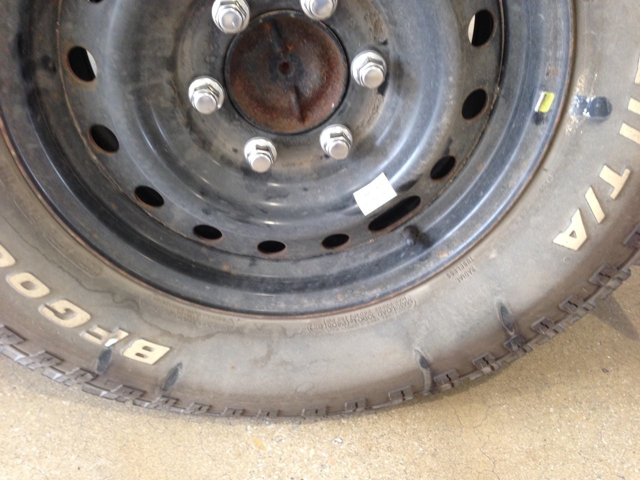

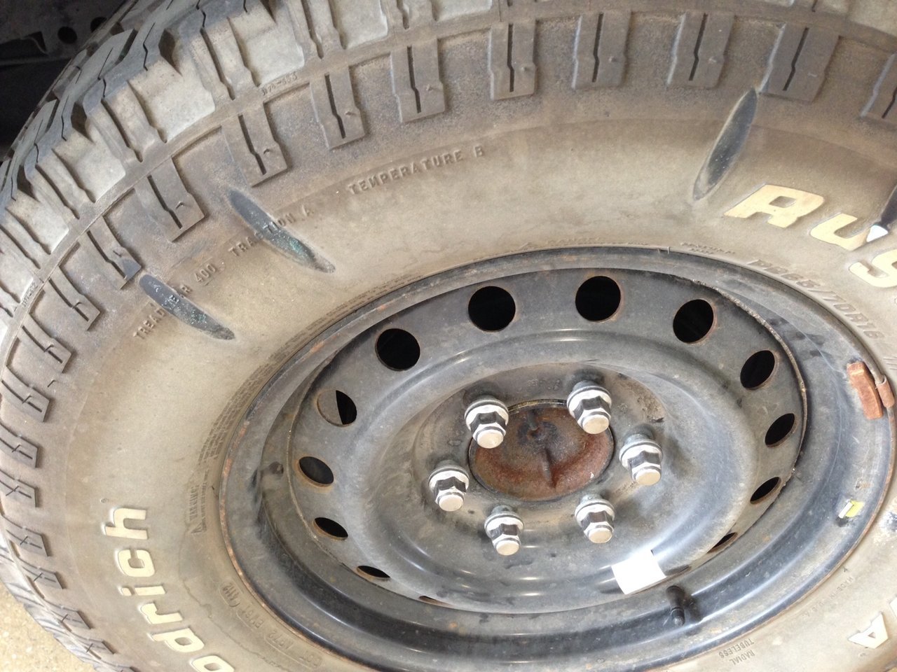

    Is anyone still experiencing this? I have. 2013 with just 20k miles. Just had a flat, and he spare wouldn't hold air. Upon further inspection, I found the rubs. I don't think it was because the spare was loose. f1a005262d9b0aa97b0a0aaa7f50539e_ed58a8885b1b6e43e13713244094dcd8151965cb.jpg852e88a51520a89d8468274975ad6e36_dbc5a01b1997a15a022376e34f0d2c98429bcbc6.jpge6b1504fe3a9ea4d85be0f937625c936_93c5c0a422711addcb8a9452ba11d35110f121f2.jpg9449d241b79d5f154bb7d091b2c64828_80e43ee3a839adedc4ef9df5a505cf83c8516298.jpg

    Looking / zooming in on that last picture where the rub mark is over the "traction" small lettering debossed in the tire side - it looks like the lettering has not been rubbed off. It leads me to believe that this location is not so much worn, than indented with a "memory" of the under cross mounts. Regardless, it does appear to negatively impacted the tire sidewall. Perhaps a direct contact with the Tire manufacturer may give some info on any quality / life concerns ??? JIMHO

    Are you certain that it is abrasion and not just indentation? The tire will conform to the shape of the metal support, so it will show the shape. Typically this does not mean that it is actually worn.
