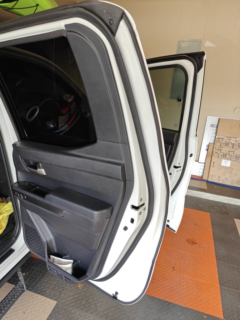

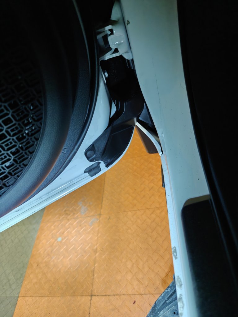

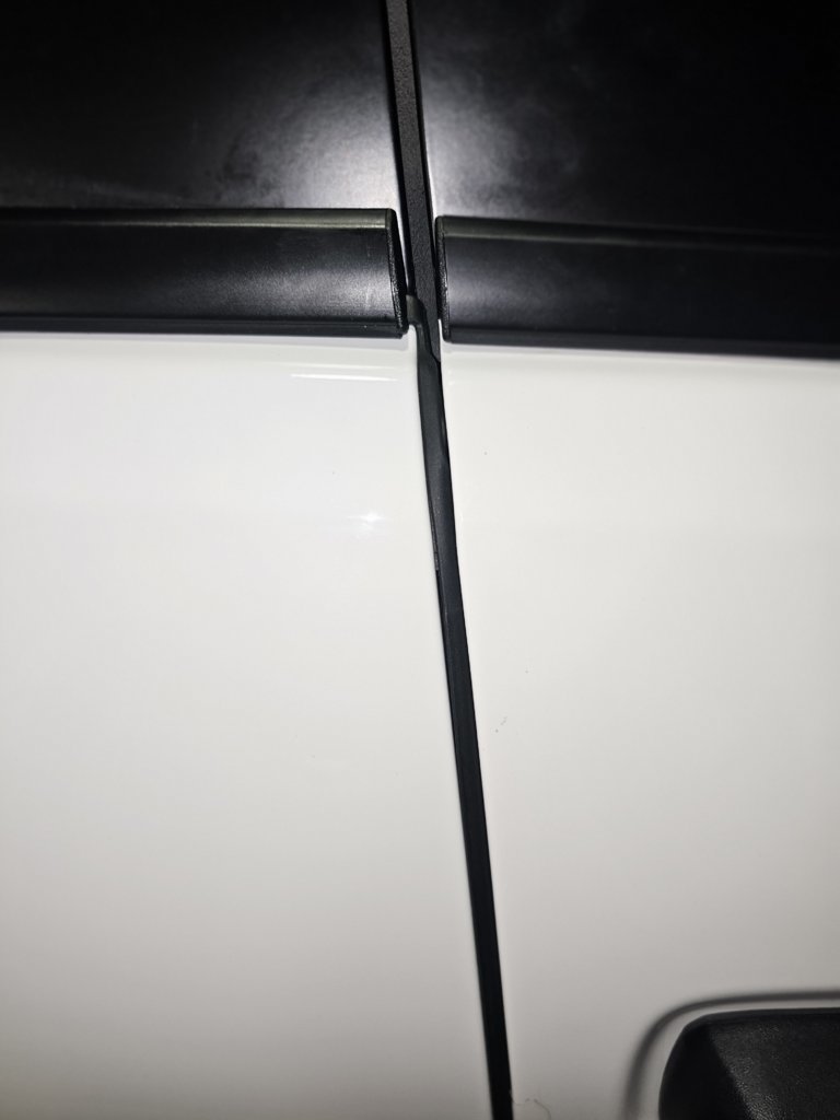

    I received the weather stripping for the front lip of the rear door and installed it. It fit perfectly. Part numbers below
    67895-AK010
    67896-AK010

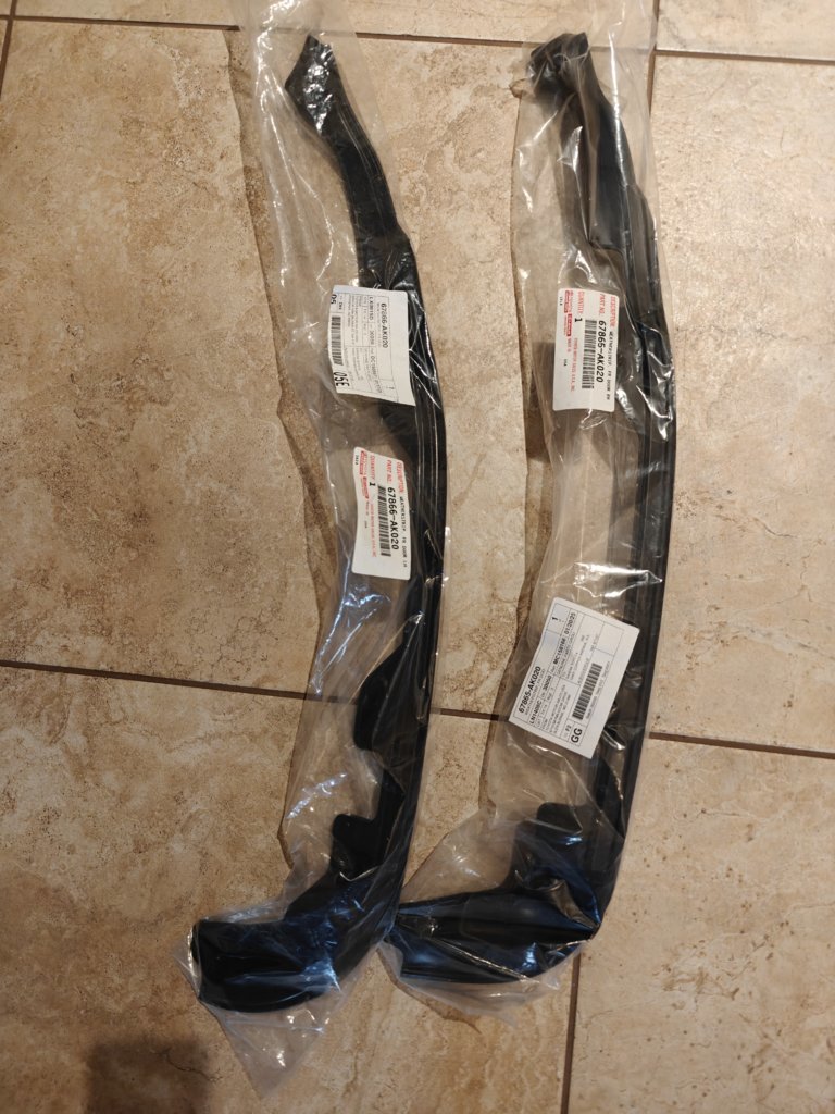

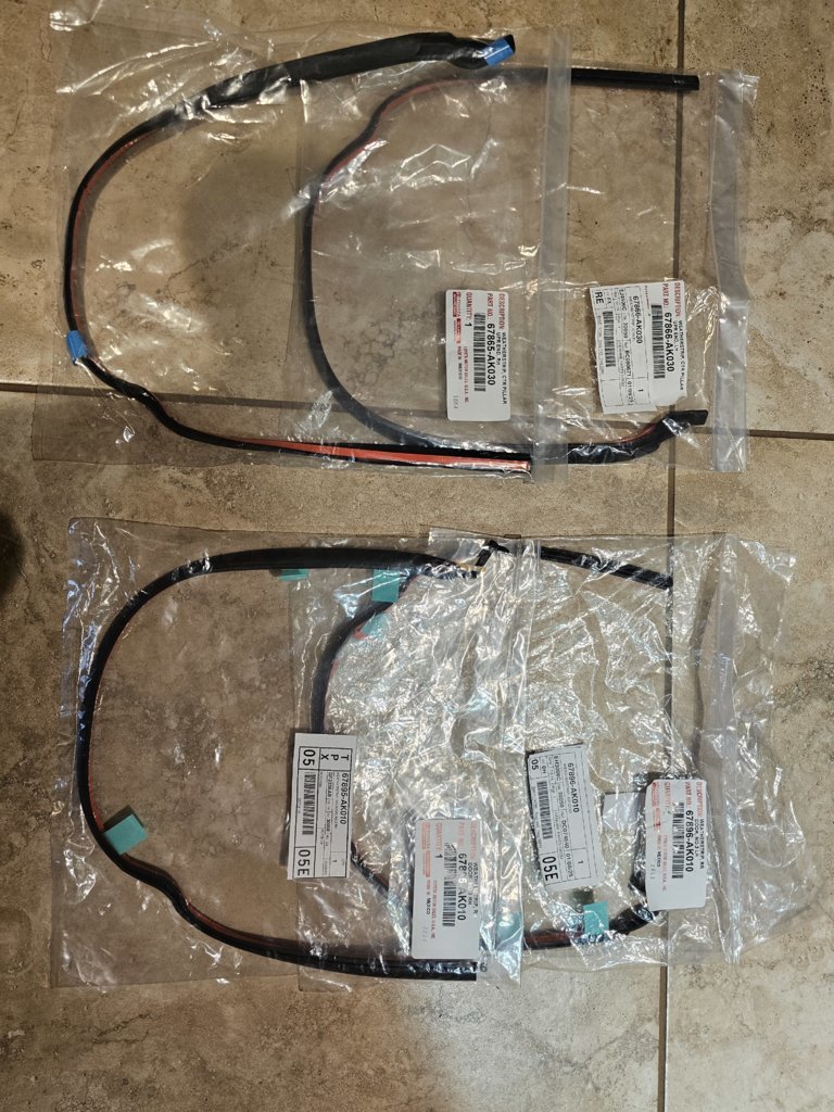

    I also ordered the parts for the front door based on info from dealer and they were the wrong numbers:
    67865-AK030
    67866-AK030
    20250117_100849.jpg 20250117_103135.jpg 20250117_102752.jpg 20250117_103345.jpg The dealer gave me the wrong numbers and I ordered online so now it would cost me 1/2 of their cost in shipping if I try to return them. I think though I can fit them on the area where the rear of the rear door meets the cab. They just need a little trimming.
    The correct parts on the other hand are:
    67865-AK020
    67866-AK020

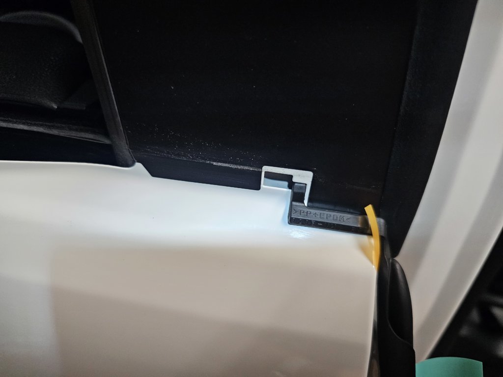

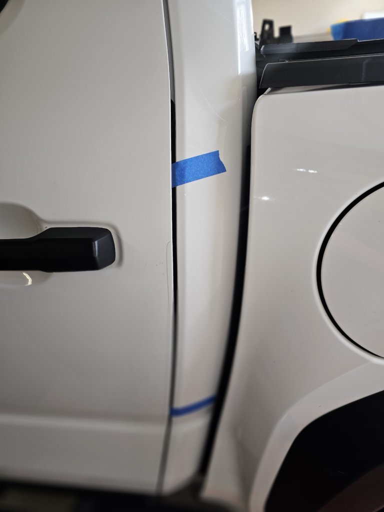

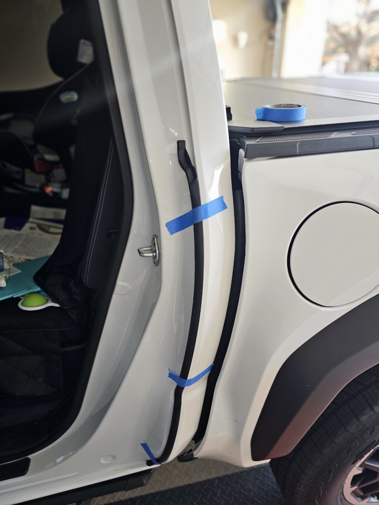

    This is a mock up of where i think the wrong parts can fit.
    67865-ak030
    67866-ak030
    I hope the is someone smarter than me who can tell me where is the correct location since these are for our trucks. I will wait to hear from you20250117_142617.jpg 20250117_142609.jpg

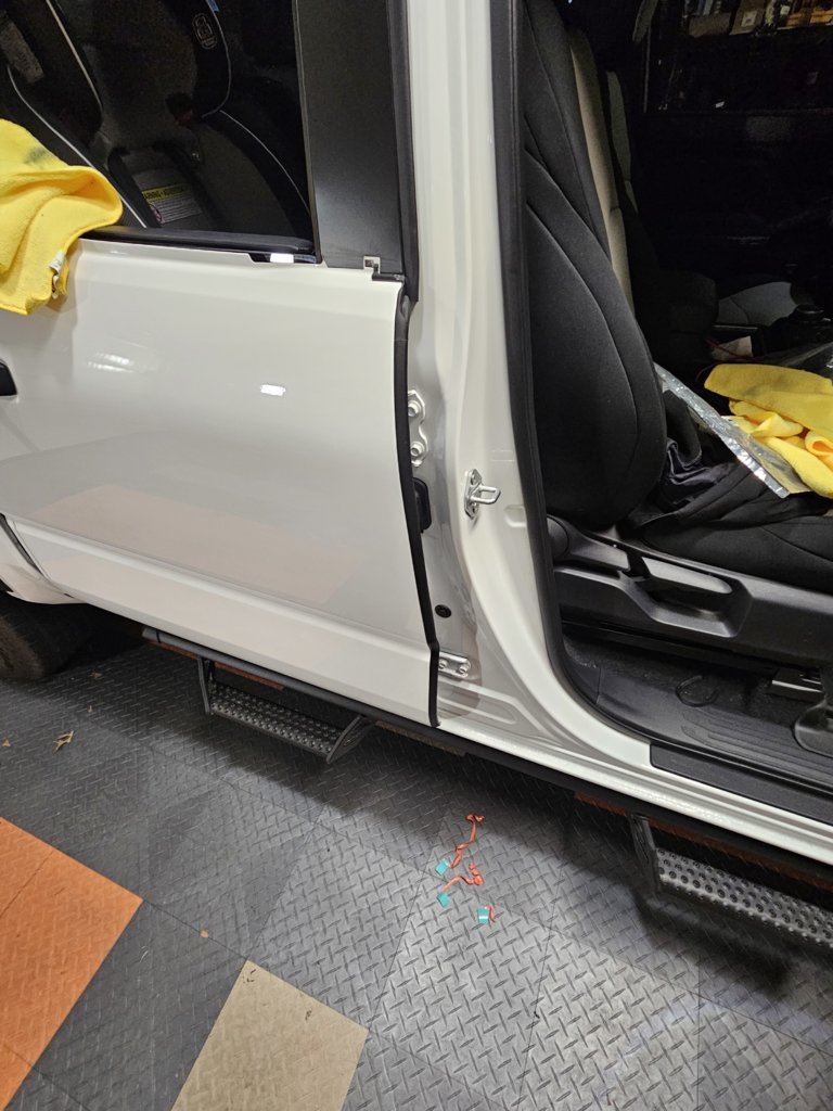

    Update, received the front ones. They are part plastic with a rubber edge. IMG20250127085636.jpg

    I just installed and my ears didn't detect any noticable difference. The wind noise I mostly hear is coming from A pillar area so it is possible it is coming from my ditch lights. So I am going to conclude that this stripping will help with less junk and road grime entering from that space rather than reducing wind noise. Having said this. I may weather seal the bottom edge of all doors and the rear edge of rear door to reduce / eliminate road grime in my jambs.

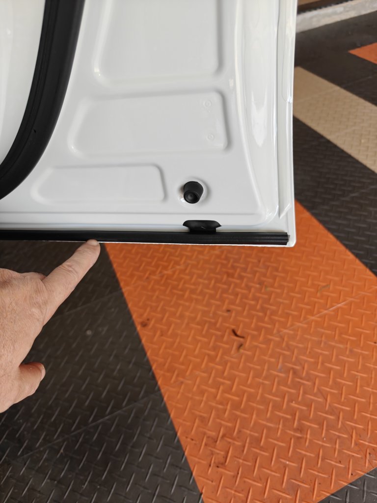

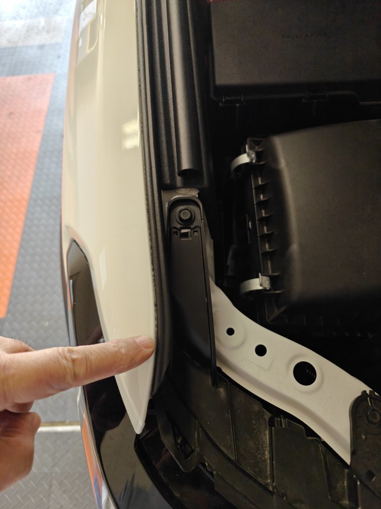

    Latest universal weather stripping images for hood, front and rear doors. I have 18" wheels and the truck is pretty quiet now. I only wind noise I hear is coming from the ditch lights which is to be expected. However, I can't honestly say which was the biggest contributor.IMG20250130122829.jpg IMG20250130122843.jpg IMG20250130122901.jpg
