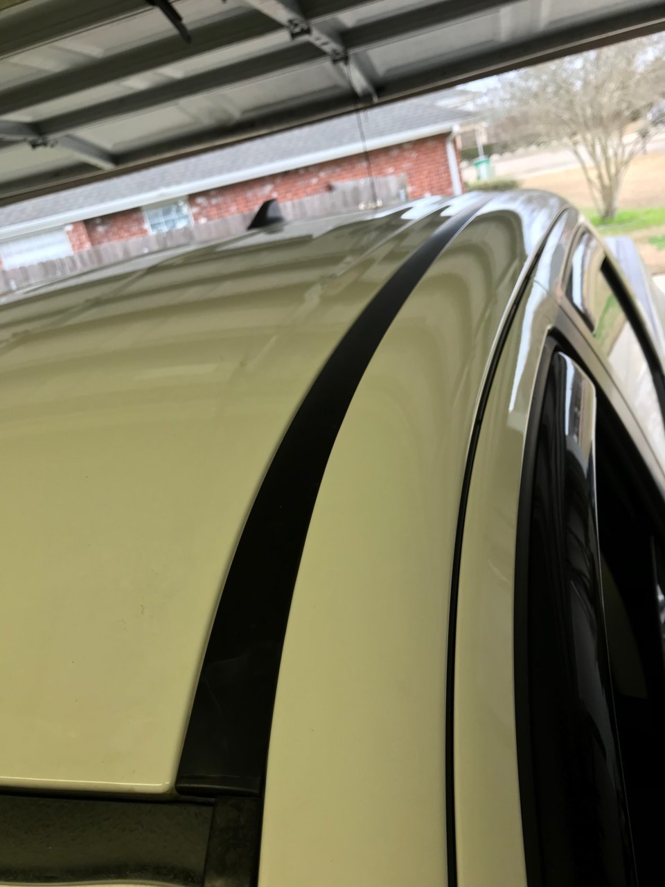

    Hey guys, I would have googled this, but I don't even know how to phrase the question.
    The black rubber weather stripping-like thing came loose on my truck. The one that runs from the windshield on the drivers side up and over the driver's side doors. I pushed it back into place, and it's holding alright, but looking close I can tell that it's not flush like it used to be.
    What would you recommend doing?

    Same thing happened on mine. Took it to the dealer and they glued it in. No problems since.

    There's a sticky double sided 3m strip towards the middle of the weatherstripping along with channel's the weatherstripping will fit into. Check for that. Maybe redo the 3m strip.

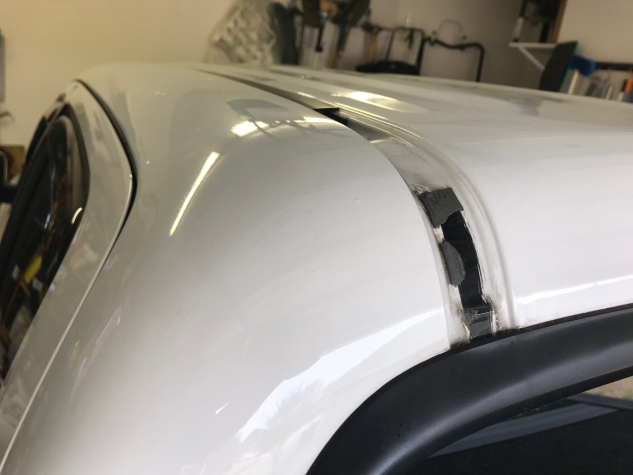

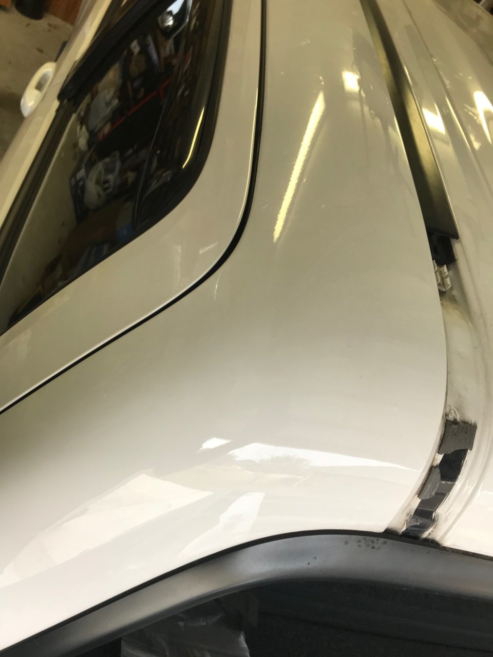

    My rear drivers side trim came off too, must be some new environmentally friendly 3M tape, or it's the 3rd Gen turd curse catching up with me ugh!
    Anyway, '16 is out the 3/36k warranty so here's what I did.

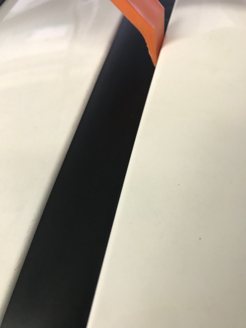

    First make sure to get the right part from dealer, (about $80-90.00?) remove old trim with trim tool. Simply wedge it and pull up it comes off easy.
    Scrape off all the old tape/glue, but make sure you leave the tape covering the rack mount fastener holes covered up. I used acetone after trying alcohol to completely remove old glue remains.
    Next is to put the new part in, just set it in place first to seat it in the right place, then start at one end by peeling the tape and use the trim tool to set/push it all the way in. I can't stress it enough to take your time and make sure it's seated all the way.
    Last but not least, reward yourself with a cold one. Or if you subbed it out to the body shop, tip the guy so he can have a cold one for you!
    Cheers!
    Edit: I lost my section to the wind, but if you have yours and it is in good shape, just be sure to use 3M high quality trim tape and you should be GTG
