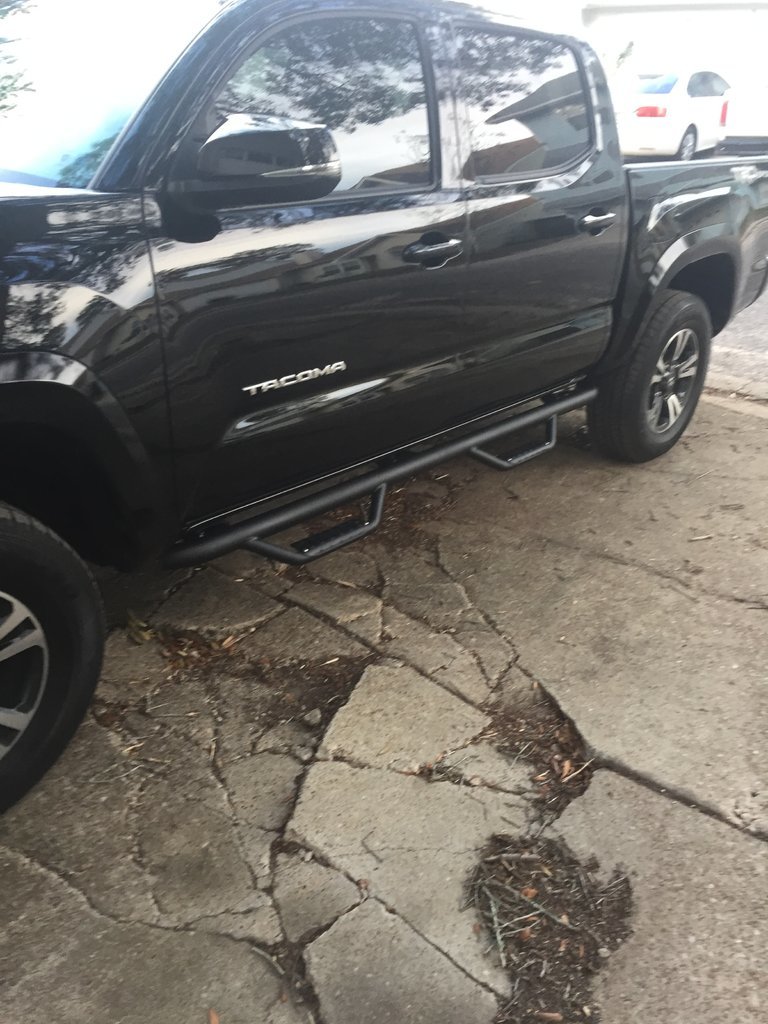

    Honestly i didnt notice a difference until i went to install them, but i imagine that the fender is a bit wider. If one of the screw holes doesnt line up when you install them them you got the wrong ones. I'll try to find a decent pic of my truck amd put it on here...

    Thanks. Looking at your pic, I probably ordered the wrong ones. Well, I'll know for sure when they get here!
