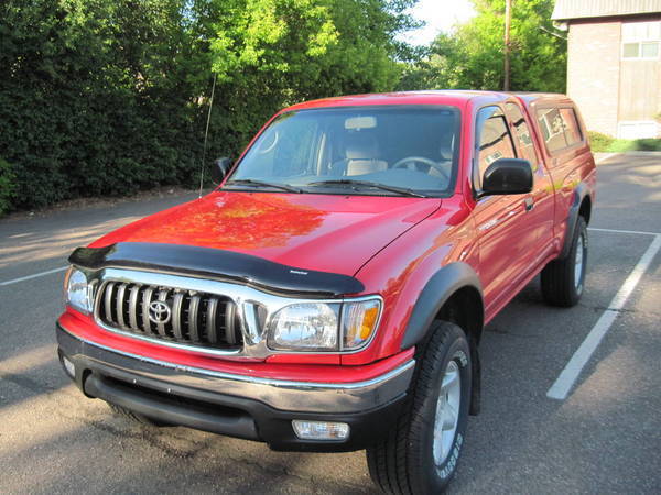

    I have an avs one and I have it: hood, deflector, weatherstripping. I had the same problem as you and my fix was smaller screws. It is holding great after a year and a half.

    Yes, I that is how I have it. Im not sure if the AVS one is different than yours but it works great on mine. Here is the best pic I have of it.
