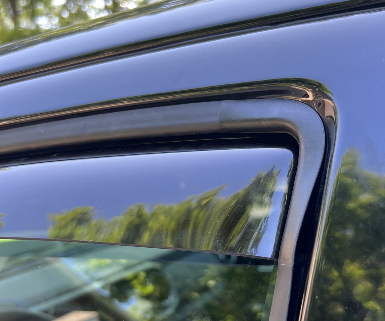

    Hi all,
    I recently installed the weathertech window deflectors and only on the front drivers side, it seemed to be interfering with and pushing out the window gasket. Weathertech sent me a new pair but it seems as if the damage is done. Could this be how my truck was designed and it’s an isolated issue?
    Has anyone else encountered this issue or have any advice on how to fix this?
    Thanks!

    Can't tell but your deflectors may not be sitting in the channel high enough or as far up as possible.
    I put the deflectors in the channel with glass down, all the way in, and to the top. Make sure everything is good including weather stripping before closing the glass.
    Good idea not lower or work the windows for 3 days after install so the adhesive can cure.

    I’ve uninstalled and reinstalled 5 times. I’ve currently removed them to see if my window gasket will settle back in. I’m thinking it might be a defect on my truck.
    I’m also planning on slightly trimming down the back end piece to see if it fits better and doesn’t push hard on the window gasket.

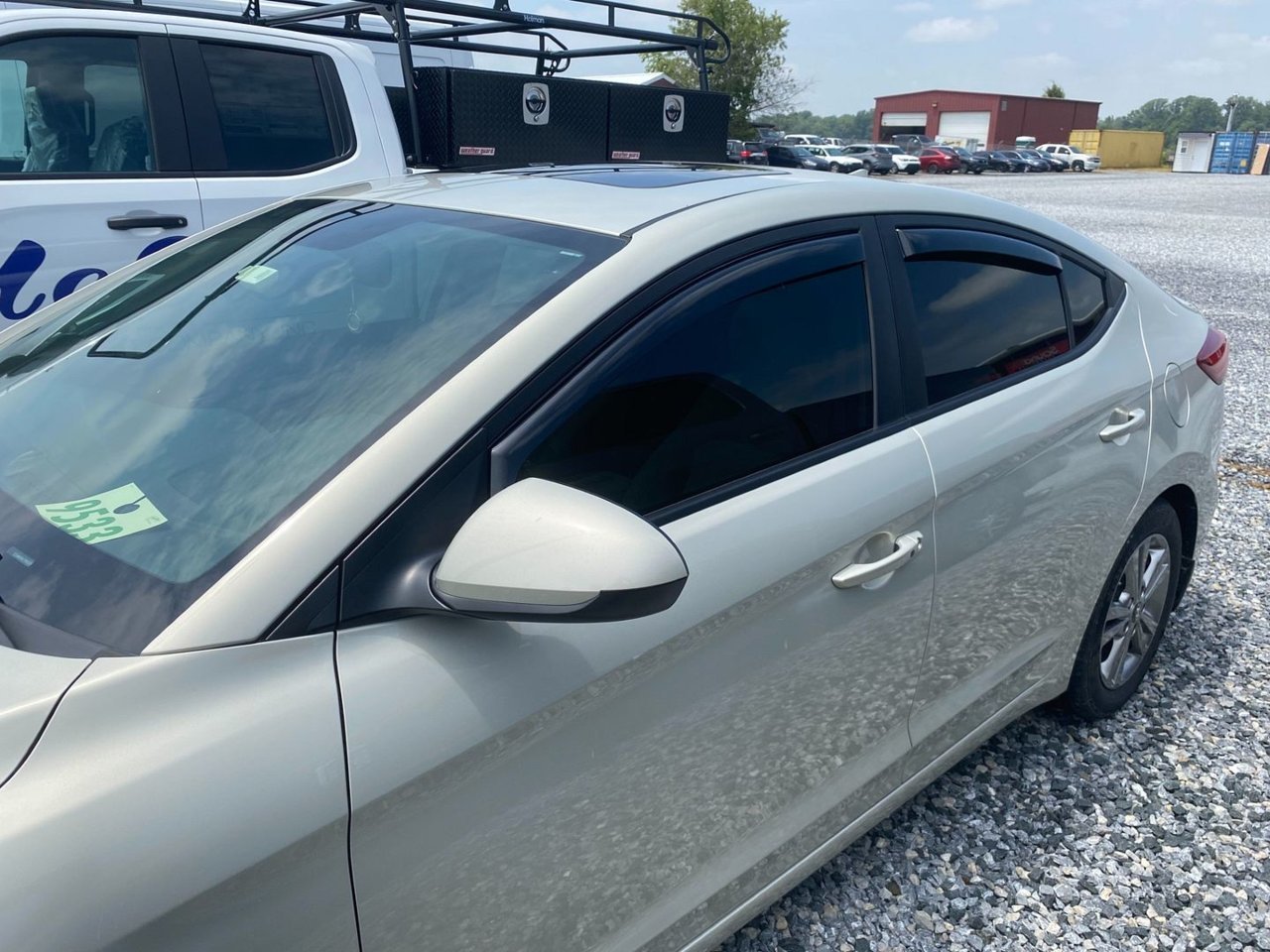

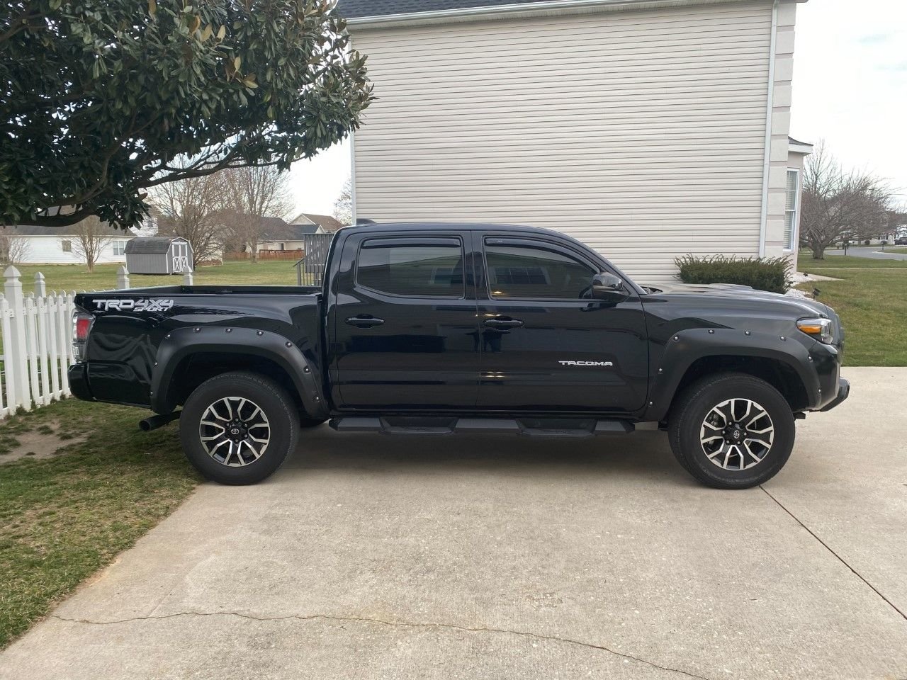

    In-channel window guards need to be properly installed otherwise, there will be problems.
    I've had the same shop install my Sport's as well as my wife's Elantra's done and they are fantastic.
    Here's mine!

    Trimming the inserted section a bit should be fine. I trimmed the driver side on my 18 Tacoma because it had sharp corners and was pushing on the gasket (not as bad as yours). It never moved a bit or had any issues with the window.

    Yes, this is only happening on the driver side. I currently have removed the front driver side and will trim down the back end a bit to see if it provides less pressure.
