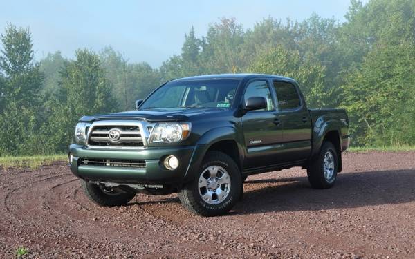

    I put this on over the weekend and I'm overall very happy with it, but I did run into some issues.
    It *would* go on in a matter of about 5 minutes from unboxing to cleanup if you trusted how it mounts and fits, but I didn't, and neither should you if you're planning on getting one and care about your truck :)
    It's well made and looks to be heated and bent or pressed into the correct shape. Unfortunately no two are exactly alike I'm sure, and some of the bends cause the edge of the plastic (lexan?) to end up facing not the same way as the rest of the "line". They're all going to fit just a little bit differently.
    The supplied mounting hardware would probably suffice, but it's not a tight fit and the deflector can be moved around a bit after install. I opted to modify a few plastic sheetrock anchors for (4) of the mount points, added some double-sided tape, and used (2) of the included fasteners on the remaining spots. The double-sided tape wasn't just to strengthen the install, but also to fill the space that permits the deflector to rock a bit when installed.
    I also used the included clear rubber bumers strategically in 4 spots on the underside if the hood to prevent the deflector from hitting against the front edge of the hood when the hood is down. Without the 4 bumpers, my deflector definetely hit against the hood in 3 spots.
    Additonally, I ran a length of black vinyl tape (electrical tape) along the whole front edge of the hood folded underneath with relief cuts on the curves to protect that front edge in case it does still rub somewhere. I imagine the tape will leave a sticky mess on the edge of the hood should I ever need to remove it, but sticky gunk cleans off. Scratched paint, or bare metal is another story :)
    Last but not least, as I mentioned in the beginning the bends in the deflector cause the edge of the material to stick out in a couple spots and mine was hitting against the grille and headlights on both sides. It wasn't "crushing" into it, but hard enough that given the sharp edge of the deflector that long term I had definete cracking/gouging concerns.
    I popped a sanding drum on my dremel, marked the spots, and carefully smoothed the edges on the deflector in the spots and took off just enough material that with the hood down, it didn't touch the grille anymore. It still rests on the headlights lightly, but not with a squared edge anymore, it's rounded off.
    I know it sounds like a lot of work, but with only 5k miles on my truck, it was worth it.
    With these steps, I believe I could pull this deflector off 100k miles later with no damage or wear to the truck at all.
    How's it look?
    -Rich H.

    looks good to me. how about some closer pics so that we can see what you did differently in mounting?

    Yes, when I get a chance I'll shoot some pics showing mounting, and where I dremelled it.
