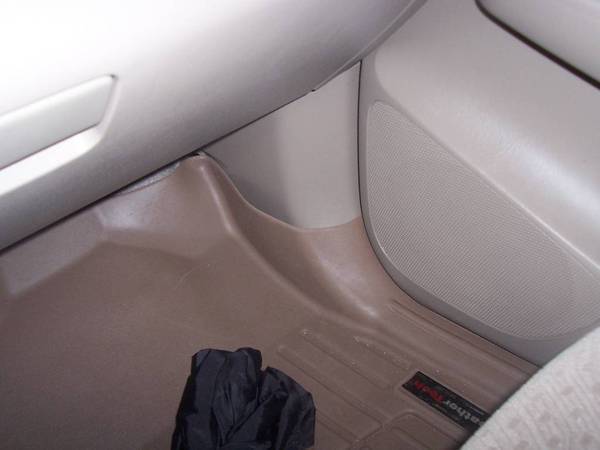

    In the first pic, I put a bit of pressure on the mat to simulate the way it would be with someone's feet on it:
    In the second pic, the is no pressure on the mat and it's hard to see the gap, which is about 3/8"

    Looking at my own pics, I see there's a black plastic fastener holding down the kick panel where it contacts the carpet and protrudes some. I think the liner sitting on it causes the gap to form when pressure is put on the liner...

    On the passenger side, I took a small razor and cut a little crescent so the top right corner would drop behind that black plastic nub on the floor, fits perfectly flat now...

    You have to tuck it under that black nub thing. I thought the same thing when I first put it in and was like wtf this doesn't fit like everyone said. Then I jacked the thing back and popped the corner of it under that tab and now it fits pretty darn good. Try that first and if it doesn't wanna go under or buckles or something just cut enough material to make it so it slides under it.

    heat it up with a heat gun and mold it for a better fit

    Sorry for the delay in getting a few shots.. Nothing special, just get a razor knife and cut a small notch so the liner doesn't bind under the floor nub. Lets the liner lay down like it was intended.
